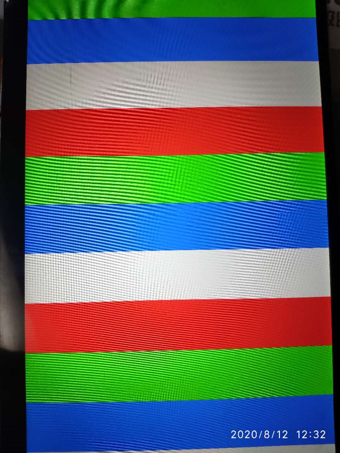

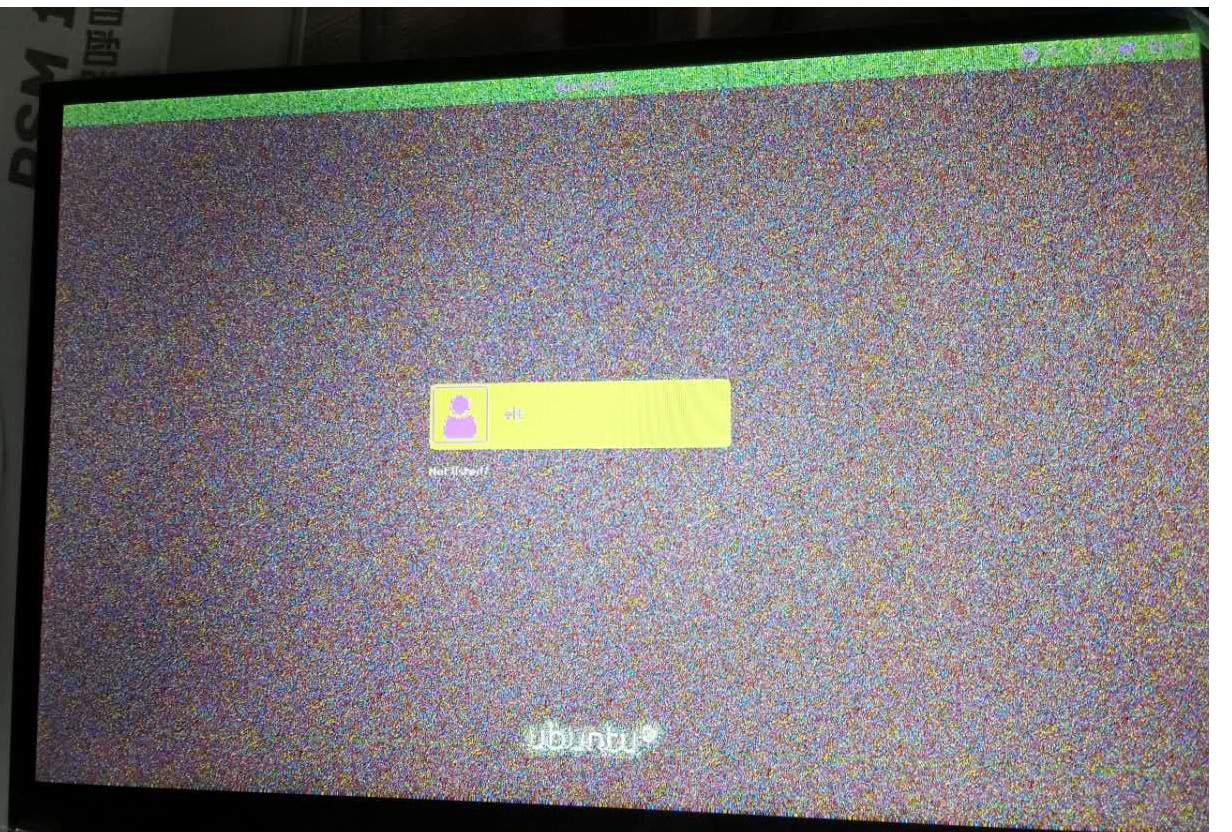

We are running this DSI2LVDS bridge on Nvidia Jetson TX2 and got poor output on LCD screen.
Is there any suggestion on configuration paramenters?
Hi Xianhong,

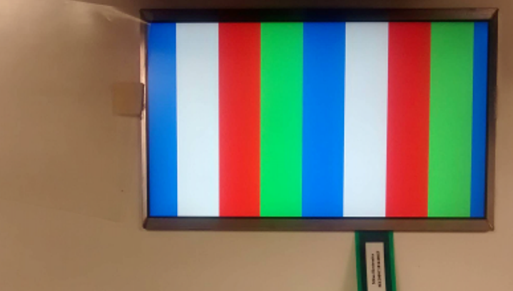

What does the test pattern look like? Also, can you fill out your settings in the DSI-Tuner and attach the .dsi file? You can reference this video as a guide: https://training.ti.com/configuring-sn65dsi8x-single-channel-dsi-single-link-lvds-operation
I.K.
Hi Xianhong,
Can you zoom out a little when you take a picture of the display? The color looks okay but I want to make sure quality is good too. For example, like the below:
Also, from the G101EAN02.1 datasheet (https://www.beck-elektronik-display.de/fileadmin/user_upload/Produkte/BECK_Display/Downloads/AUO/G101EAN02.V1.pdf), it looks like you're operating at the maximum timing characteristics (clock frequency, total horizontal pixels, total vertical lines). Can you modify your settings to use the typical settings instead? Make sure to also make these changes on the host side.

Finally, we solved this issue by changing format from "Fomat1" to "Format2" in DSI-Tuner. Thanks for your support.
