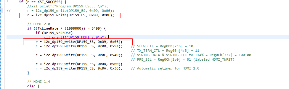

Could you please provide some info the DP159 “TMDS lane deskew” operation which is mentioned in the DP159 datasheet ?
The register 15h bit7 =high which means DESKEW_CMPLT: Indicates TMDS lane deskew has completed. Could you please help to provide details of the operation of the “TMDS lane deskew” function?
