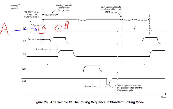

For TIC12400-Q1, each input pin have some small cap. Polling mode, IN0 channel, wetting current start form A point, ADC or comp start work form where? A or B or middle?

Hey Adam,
The drawing in the figure indicates the time between enabling the current sources for each channel, set by Tadc or Tcomp. That is to say, the figure shows the waveforms you should expect to see and what spec corresponds with them NOT the internal timing or when the ADC/Comp are active.
As far as actual operation, the timing is described as follows:
So to answer more directly about whether Tadc/Tcomp start at A, B, or somewhere in between the answer would be B, as the datasheet states:
