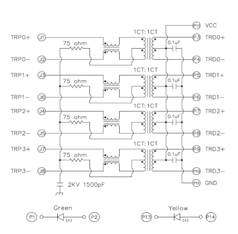

Hello Team,
can this connector from Wuerth be used: https://www.we-online.de/katalog/datasheet/7498111120AR.pdf ?
I am concerned regarding the 4 x 100nF which create a short between all 4 center pins.
