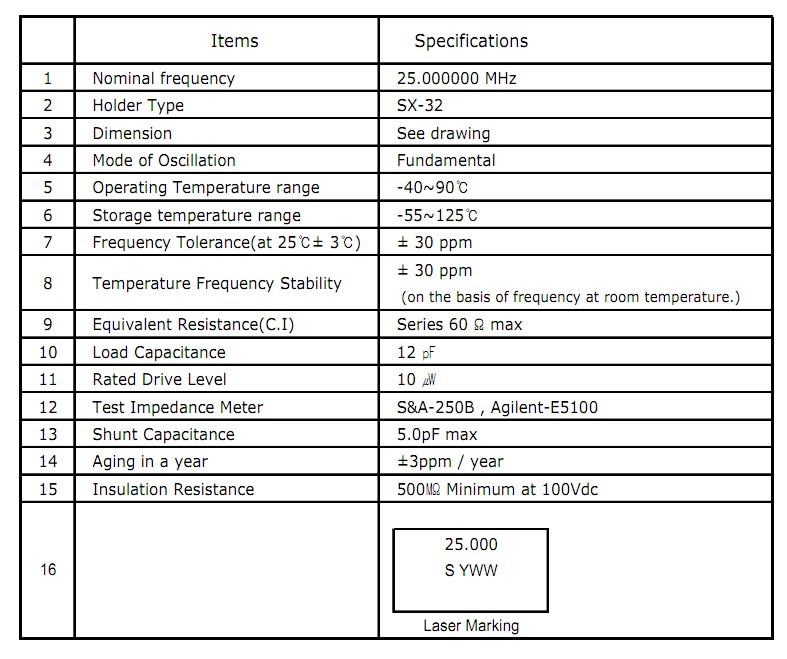

  • Hi Cecilia,
    Could you double check schematic and send me resolution?
    Here is Clock ppm of MAC, PHY.
    Below is actual test result on B'd.
     -. MAC Crystal Clock (SoC) : 24MHz / 3ppm
     -. PHY Crystal Clock : 25MHz / 17ppm
    Below is Crystal Spec. Data
    Here is schematic
    DP83867IR - PHY.pdf
    Michael
  • Hi Michael,
    What is the MAC Clock used for? Is that being supplied to the PHY or just used for SMI?
  • Hi Cecilia,
    I don't know well what your asked.
    Could you please explain more detail?
    For your information, MAC is integrated in their SoC IC.
    As I mentioned, SoC use Crystal Clock = 24MHz. PHY use Crystal Clock = 25MHz.
    If you see the schematic, they use  GTX_CLK of PHY.
    Michael
  • Michael,
    My question is, are they using the TX_CLK from the MAC? Also have you confirmed that the clocks have the correct skew for TX_CLK and RX_CLK?
    Cecilia
