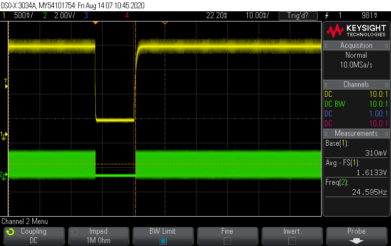

My customer reports a situation that I cannot explain. Please help.
"We have found that the Ethernet PHY (DP83822) does not always come correctly out of reset.
When we boot the product I do not believe we have seen any issue. The issue comes when we reboot our host processor, this then generate a reset pulse to the PHY and sometimes the PHY does not come up correctly after this.
Attached are captures of RESET_N and RX_CLK. I have just driven RESET_N low, then high from our host and here you can see that once in a while PHY does not start correctly. We are not cycling anything other such as power etc. – only RESET_N pin.
I first expected it might be due to actual low level of the RESET_N signal (on measurements 310mV – we are using diode to pull low) however I also tried reducing this further to 10mV and no change.
I will try to increase risetime, but other then that I am a little perplexed on what is causing this.
For reference we are currently running: AVD = 3.3V, VDDIO = 1.8V.
Also tried using phytool to read out some registers (0x00 and 0x17) and when in this mode they both readback 0xffff."
Not OK operation:
OK operation:
Looking forward to your advice.
B.r M.A.M

    Does the processor also reset the clock? Are you using a crystal as the input of your XI pin? XI clock must be stable for 10us during the RST pulse width.
    Also I don't think I see the measurements on the scope but what are the RST pulse widths on the Not OK and OK operations?

  • Cecilia,
    Customer answers  "We are using external crystal connected directly to the PHY. And it appear there is no stop of oscillation during reset."
    The scope show that RESET_N is low for a 18ms pulse when NOK, and 13ms when OK.
    I hope it clarifies.
