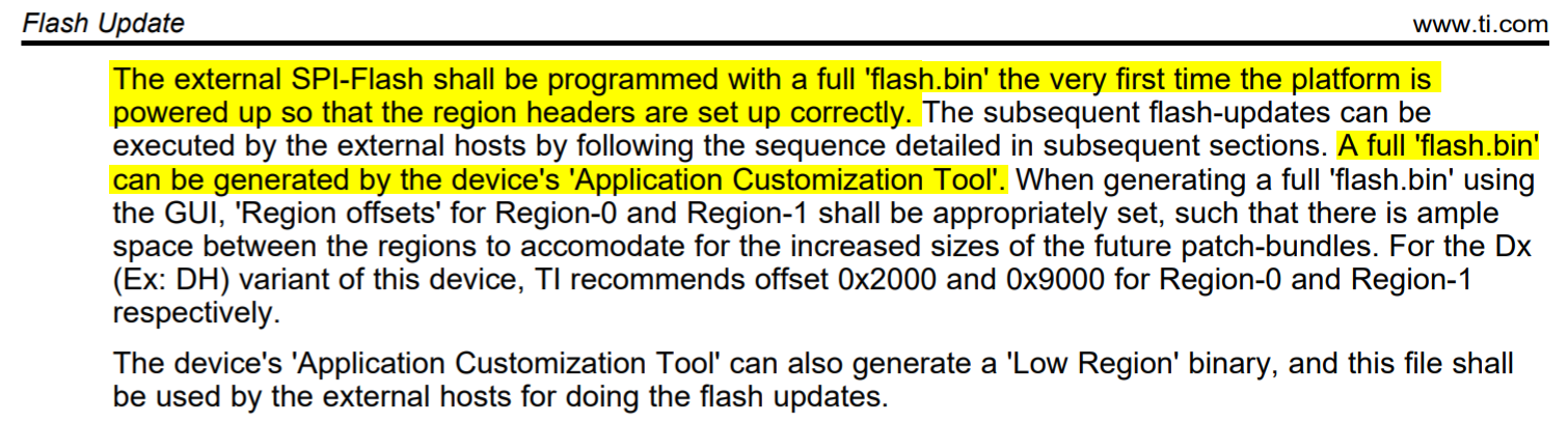

  • Hi Sam,
    One thing you can check is the SPI Flash first. It seems like you may not have an existing configuration loaded there first. Your EEPROM may be blank or it could be trying to push a patch to the blank memory, which could be causing this issue. First you have to program a valid full configuration on the EEPROM and then update it using I2C writes as you are trying to do.
    I would also recommend looking over the Firmware Update Over I2C application note, Section 4 is where it goes over the Flash Updates in more detail. Here is the section where it mentions what I was describing earlier:
    "The external SPI-Flash shall be programmed with a full 'flash.bin' the very first time the platform is powered up so that the region headers are set up correctly. The subsequent flash-updates can be executed by the external hosts by following the sequence detailed in subsequent sections. A full 'flash.bin' can be generated by the device's 'Application Customization Tool'. When generating a full 'flash.bin' using the GUI, 'Region offsets' for Region-0 and Region-1 shall be appropriately set, such that there is ample space between the regions to accommodate for the increased sizes of the future patch-bundles"
    Are you able to confirm if a full flash has already been programmed on your SPI Flash?
    Thank you,
    Hari

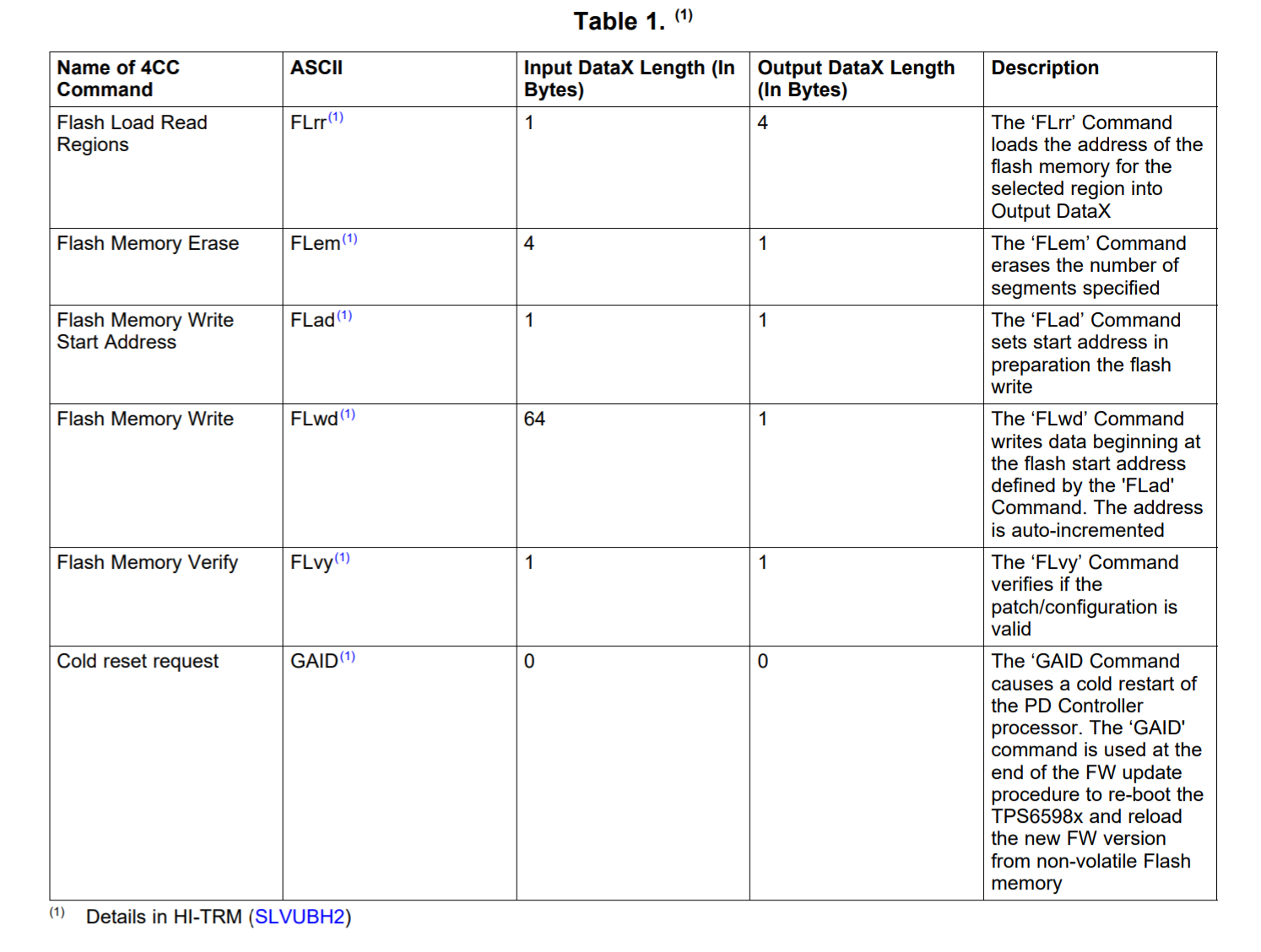

  • Hi Sam,
    The application note is about the firmware update but it also details programming the blank SPI for the first time. The section that I quoted in my last responses explains the reasoning, I've included it below as well.
    The steps that you will need to do are also described in Section 4.3, which I have shown below and if you scroll below this table you will also see how you should be sending these commands.
    The FLvy command will verify that the configuration that you wrote to the Flash is valid and this will let you know if the process is correct if you write the correct binary data. If you get that the Flash is empty, you may not have wrote the data or something else must've gone wrong.
    The TPS65988 will store the data in Flash in 2 regions, they will be the same but will be set up so that the headers are correct for the configurations. You can see how it's broken up in Section 4.2 and Figure 1.

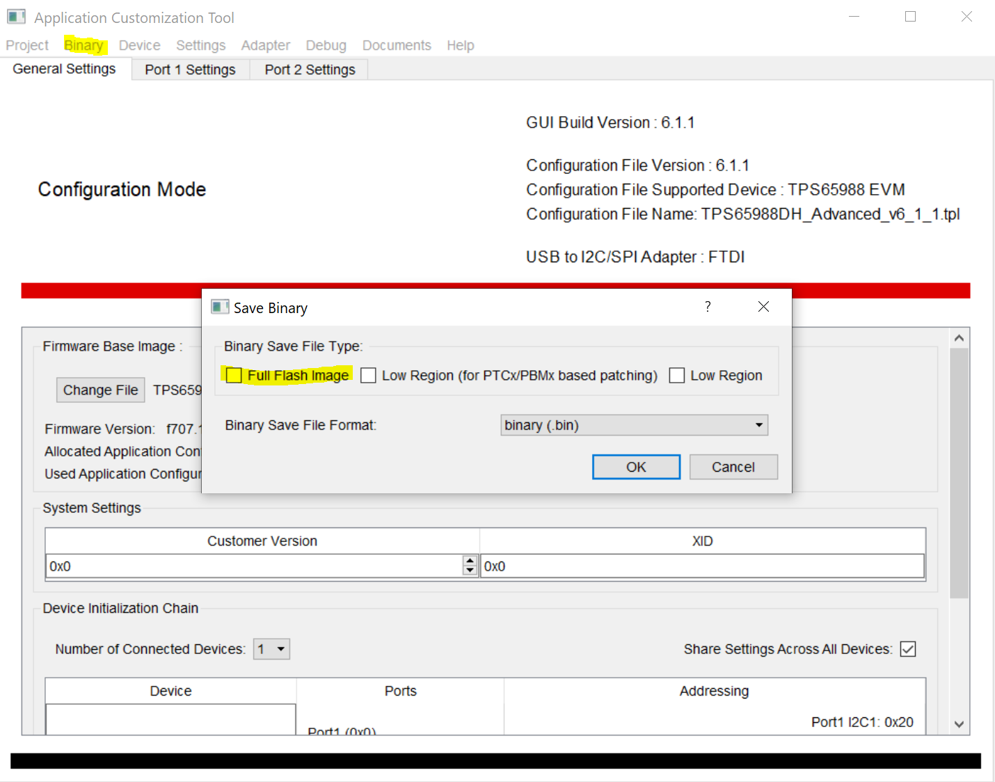

    Below is how you can extract the full flash.bin from the Application Customization Tool so that you can flash the right contents:
    You do not need to alter the regions as they will be set correctly by default.
