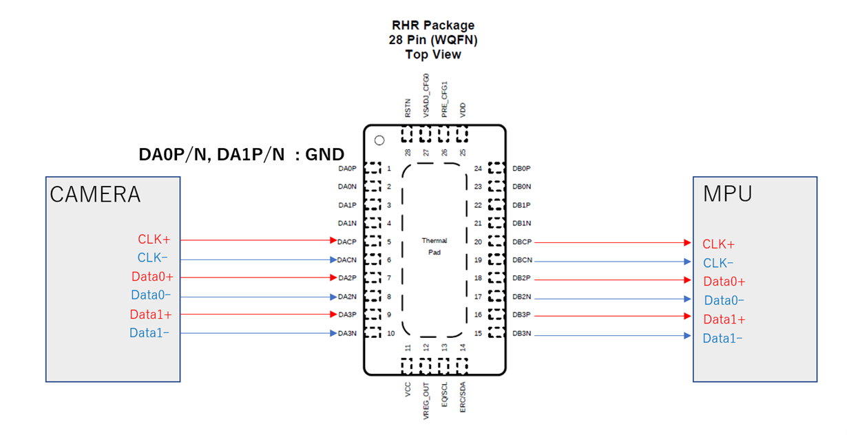

I want to use the DPHY440 with the pin assignments shown below.
Is it OK?

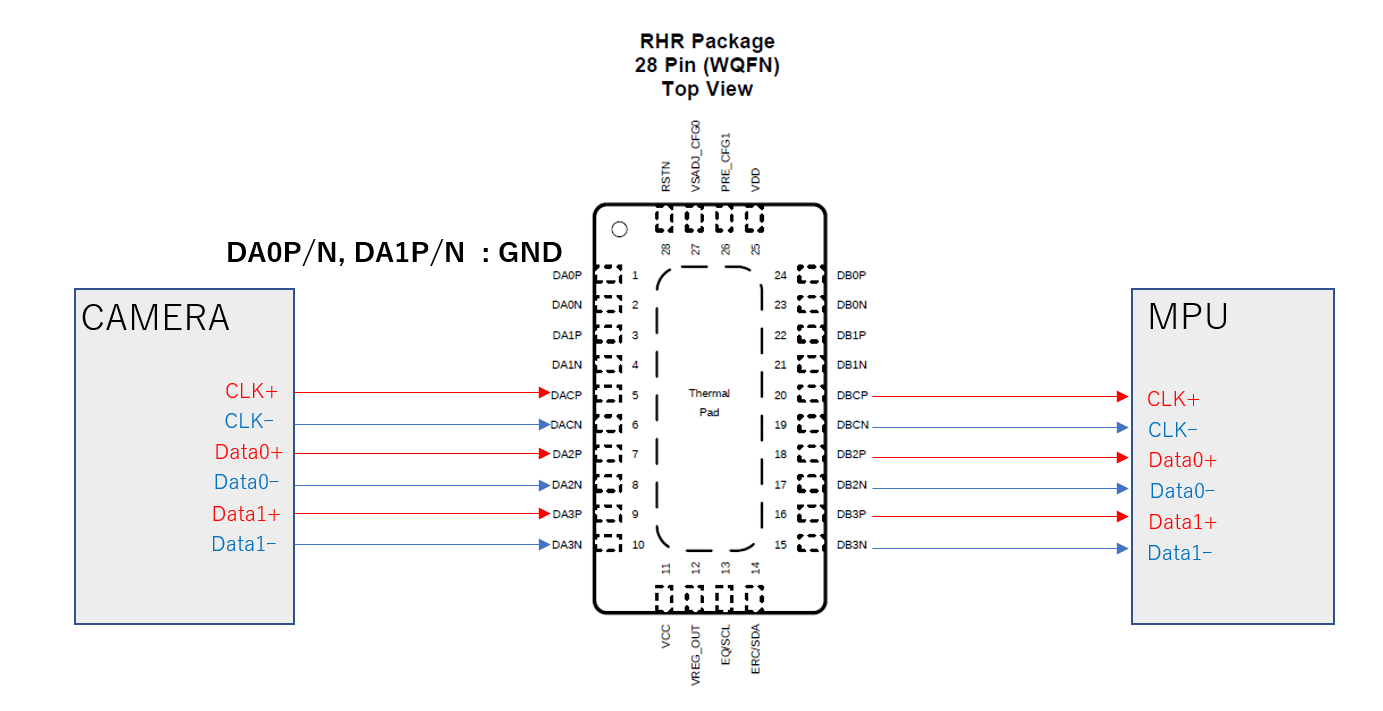

Is it OK?
Is this a CSI-2 design? If so, then the proposed connection would work. Please make sure unused inputs are tied to ground.

Hi David
Thank you for your information.
Yes. This is a CSI-2 design.
I've acknowledged below :
"Please make sure unused inputs are tied to ground."
