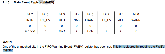

My customer is using USBN9604 on their system.
Though it is written that "This bit is cleared by reading the FWEV register." on the datasheet as below, they say that WARN bit is reset even though FWEV is not readout.
What is the cause of reset?
