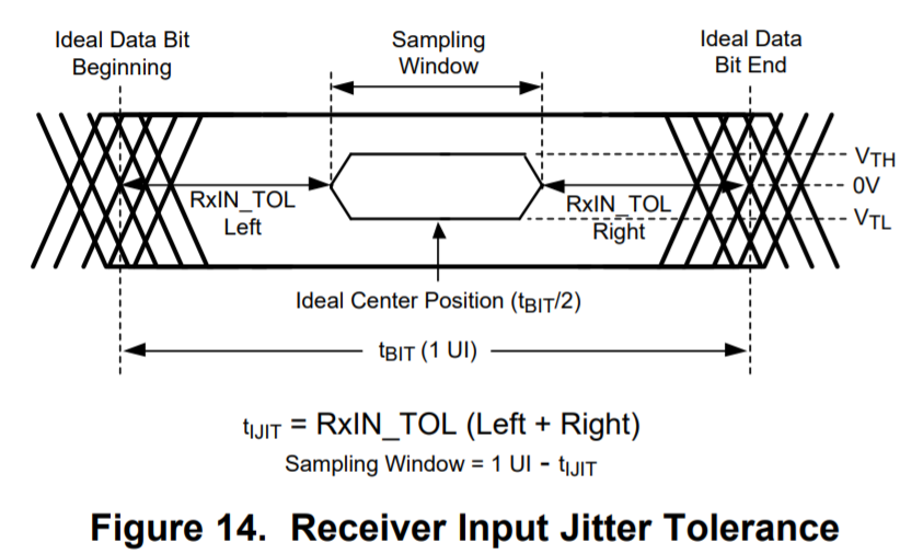

Part Number: DS90UB924-Q1
Hi Expert,
For DS90UB924-q1, do we have specific spec for the Tijit?
BRs,
Wilson
Hello Wilson,
Please give us a couple days to double confirm the specification and measurement method for you
Casey
Hi Wilson,
The sampling window for the 924 is called Ew and is spec'ed as 0.4 UI. this means that tiJIT=0.6UI.
Michael W.
