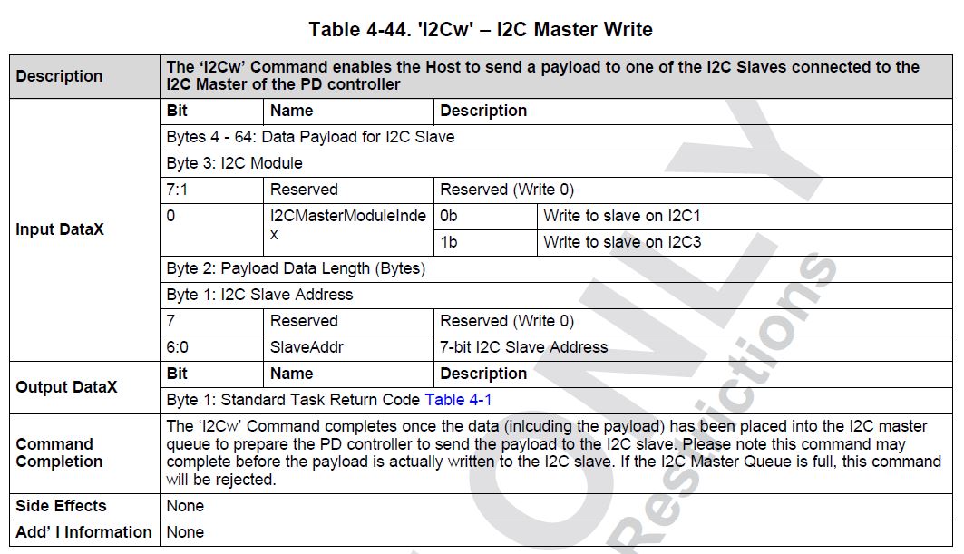

  • Hi Timo,
    For the I2Cw/r command, you can use them by writing to the BQ slave address, the data length and data.
    The data format is the same as in the I2C Master Event Table or the apps. note.
    Give it a try and see that works for you.

  • Hi Peter,
    Our set up is such that we have MCU connected to TPS65987 I2C1. BQ25703 is connected to TPS I2C3 port. During boot time TPS sends BQ configuration via I2C3, this is working.
    However, we want to change BQ configuration after boot (we'd like to change charging current dynamically) by MCU using 4CC I2Cw command. This scenario is not working - when MCU is writing I2Cw command to TPS, TPS responds by clearing CMD register (0x8) - so we assume that the I2Cw command is accepted. But we don't see any activity on I2C bus when oscilloscope is connected to I2C3 SCL/SDA.
    When Configuration tool is used in debug mode, and I2Cw command is executed, we see activity on I2C3 bus.
    In Master Configuration register (0x64) we have following:
    The whole project file is here:tps_config_270820.pjt
     Thank you for your help
    Timo
  • Hi Timo,
    Can you try using this format from your MCU and see if it works?
    Peter
  • Hi Peter,
    Yes this works, that I2C bus selection was needed.
