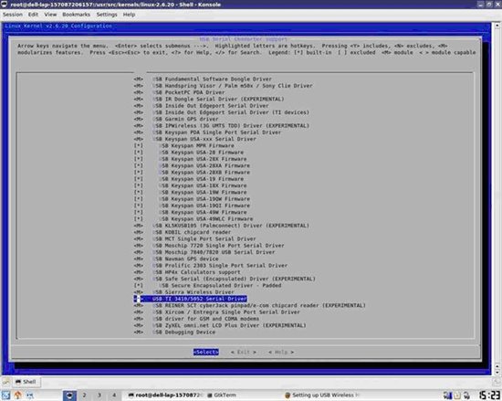

I am using Ti_usb_3410 to program msp430 via usb using debian. i am using debian lenny which has not get ti_usb modules built into the kernel. is there any prebuilt module available so that i can use. i tried compiling the package of ti_usb from www.brimson.com/downloads but the usberial.h was not in kernel source. any help

    The TUSB3410 driver is included in the official Linux kernel that you can find in kernel.org. The easiest way to put this to work is recompile the kernel that you are using (we tested with the 2.6.24 kernel) so you can include the 3410 support in it as part of the kernel. The driver should be added in the menuconfig of the kernel under
    Device DriversàUSB supportàUSB Serial Converter supportà
    Select the <*>USB Serial Converter support to be compiled as part of the kernel, and then add the <*>USB TI 3410/5052 Serial driver as part of the kernel too.
    Please see the following screenshot:
    Once you recompile the kernel and you are able to boot with the new kernel version you need to create a rule file as follows:
