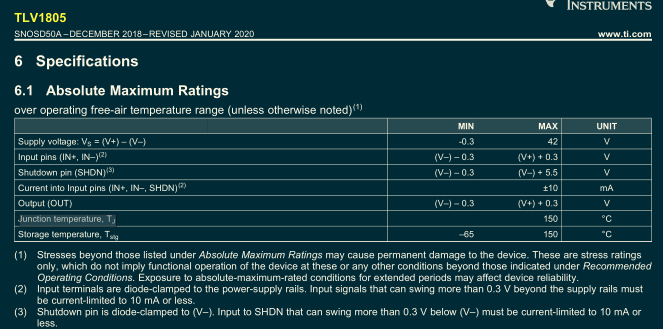

What's the junction temp max (abs and rec)? I see that we have the new thermal metrics for more accurately measuring and estimating T_J, but I'm not seeing any datasheet specs to ensure device is in SOA during real usage.
