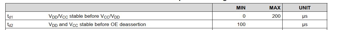

Part Number: SN65DP159
I am reaching out of VCC/VDD power sequency. We have given out that VDD/VCC should be present within 200us. Quesiton is whether it is a must for DP65DP159.

If OE is hold low when VDD/VCC ramps up, then Td1 doesn't matter, you just have to meet Td2. OE leave low level 100us after Vcc and Vdd are stable.
