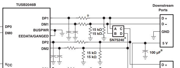

A product using TUSB2046B is failing a radiated emissions test where two thumb drives are connected to USB via USB extension cables.  The peak that's exceeding the limit is at 12 MHz * 7 = 84 MHz
The datasheet shows a matching network with 22 pF shunt caps and 27 ohm series resistors.

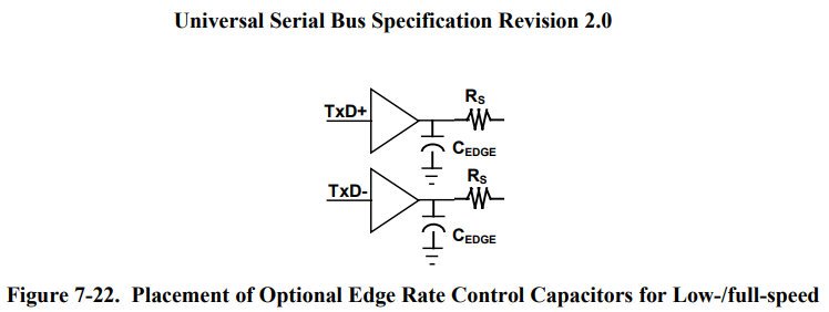

The USB spec agrees with this:
My questions:
  1. Why does the spec have the shunt cap, C[EDGE], on the source side of the series resistor rather than on the line side?

  • Hi Charles,
    The shunt cap is considered part of the 75 pF lumped capacitance allowed at the transceiver.  There is additional capacitance inherent in the board trace and the cable on the other side of the series resistor.
    There is no way to adjust drive strength of the TUSB2046 hub.  The edge rate caps can be adjusted in value as long as they are matched. they can range from 10 pF to 47 pF.  How is the shield ground of the cable connected to the digital ground?  Depending on the setup, we have seen direct  groundconnections work or improvements by adding capacitors and a 1M resistor between chassis ground and shield ground.

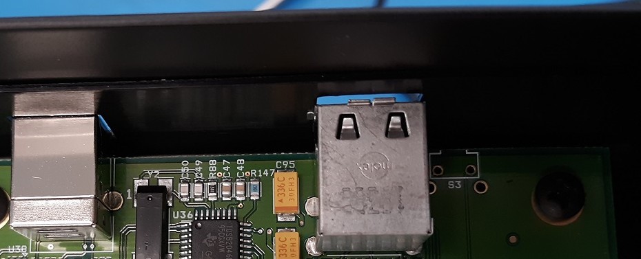

    The USB connector shied is directly connected to digital ground.  I am checking if the cable they're plugging into is grounded.

    One of my USB connectors has tabs intended to connect the connector enclosure to the product enclosure.
    What do you mean by adding capacitors?  I can get connecting two isolated grounds with 1M, so that one is not floating, but where would the caps come into this?
