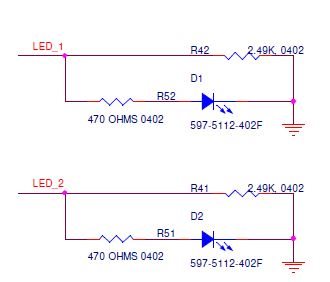

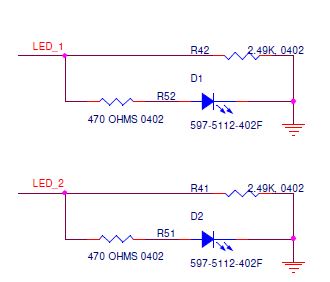

Hi All,
I had used DP83869 Phy IC for media converter in one my project.
It has both Transmitter and Receiver card.
Transmitter card is connected to the PC 1 through CAT 6 Cable and Receiver card is connected to the PC 2 through CAT 6 cable.
The Transmitter Card transmits the MDI signals (100 BASE-TX) to the DP83869 Phy IC for Converting the (100 BASE-TX) into 100 BASE-FX Fiber .
This Fiber signal has been given to the SFF module (BD5-155T3R5-DP15K-T). we connect the Optical Patch LC Cable at one end to the Transmitter SFF Module and another end we connect to the receiver card SFF module.
The receiver card receives 100 BASE-FX Fiber from the SFF Module
(BD5-155T5R3-DP15K-T) and it had been given to the DP83869 Phy IC for Converting into 100 BASE-TX Signal.
My problem is given below:
1. From PC1, I am doing a ping test to PC 2.
I got an error "destination host unreachable".
2. In that Fiber signal, I have to follow any termination at the Phy IC side?
here I am attaching the Schematics and SFF details for your reference.
Please find the attachments and give me your comments.
Note : Both Transmitter and Receiver has same Schematics except SFP Module.
          For Transmitter : BD5-155T3R5-DP15K-T
          For Receiver : BD5-155T5R3-DP15K-T
c18082b_mcc_receiver_ti.pdf2x5 BiDi Design Guide.pdfThanks and Regards,
