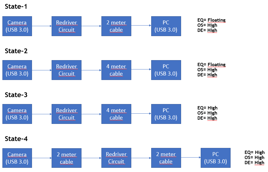

We want to transfer data over the camera with a USB 3.0 cable at a speed of 5 Gbps. For this, we made a PCB design based on the USB-REDRIVER application suggested by Texas Instrument. Also, we didn’t  observe a REDRIVER effect with the PCB board we made in the cases I mentioned in the appendix. For this, we tried some of the mods on the card's datasheet. But the REDRIVER card doesn’t work as we want. When we increased the USB 3.0 cable length, we observed that the fps value of the camera decreased. Also, when we put a REDRIVER between every 2 meters of cable, we could not see the REDRIVER effect we wanted.

    It is probably best to look at the eye diagrams for your USB 3 interface here to understand the signal integrity of your system. It would be helpful to understand the output of the camera, state 1 and state 2. What is the decrease in performance that you see (in fps)?
    Our system works smoothly for case-1. There is no fps reduction for Case-1. But in case-2, since the USB3.0 cable length increases, there is a decrease of approximately 7 fps in the camera we use.On the REDRIVER card, do the mods we use have any effect on fps drop?

    Since you are using TUSB501 only the output de-emphasis and swing will help to compensate for loss in longer and longer cables and these settings remained unchanged. in your test cases case 1 vs case 2. It is important to understand the signal integrity through direct measurement as this may be a issue of jitter rather than overall insertion loss. Also you have TUSB501 device on both USB 3 RX and TX correct? Have you tired different 4 meter USB3 cables? Some cables can perform better than others (lower losses).

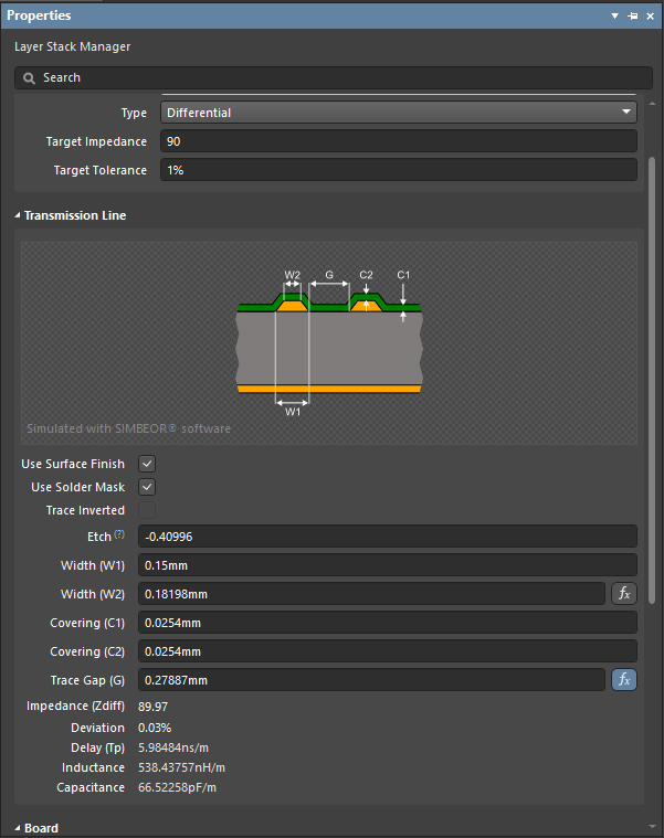

    3) Schematic and layout look good. I would suggest to keep both redrivers on the bottom layer to avoid unnecessary vias. What is the trace impedance in your design? Changing the redriver settings will only help to compensate for Insertion loss in your system. Such a drop in performance maybe caused by excess jitter in 4m cable case (and case 4). TUSB501 will not be able to compensate for jitter here.

    As seen in the attached picture, the path impedance is 90 ohms.
