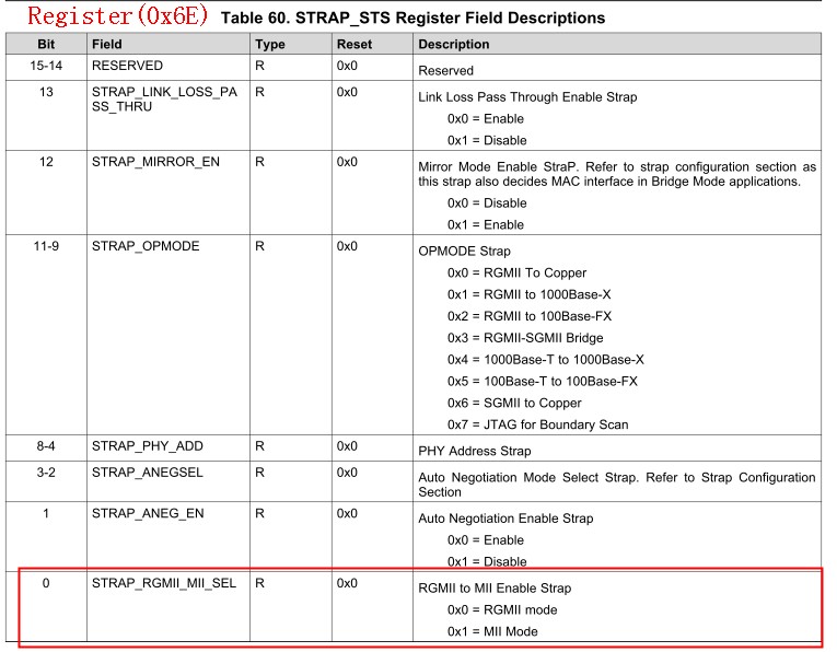

    After writing 0x001F=4000,the value of the read register( 0x1F) is 0x00.This is not a problem.But  RJ45 is still not linked.
    another problem is after writing 0x01DF = 0x0060 , Read register 0x6E = 0x20A6.
    we set the  OP_MODE_DECODE ( 0x1DF)  bit ( bit 5)  to  1, to use MII ,but  STRAP_STS Register (Address = 0x6E)  bit ( bit 0)  still  0 .

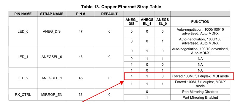

    how should I configure for  resistor to set  MII to copper  or make  RJ45 to link?
    according to datasheet:
    (1)
    (2)
    Johnny

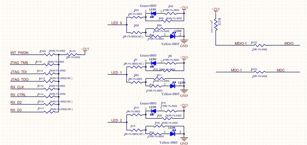

    Can you please share the schematic you are using for this application and describe what link partner and capabilities you are using to link?

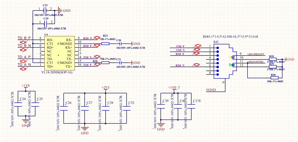

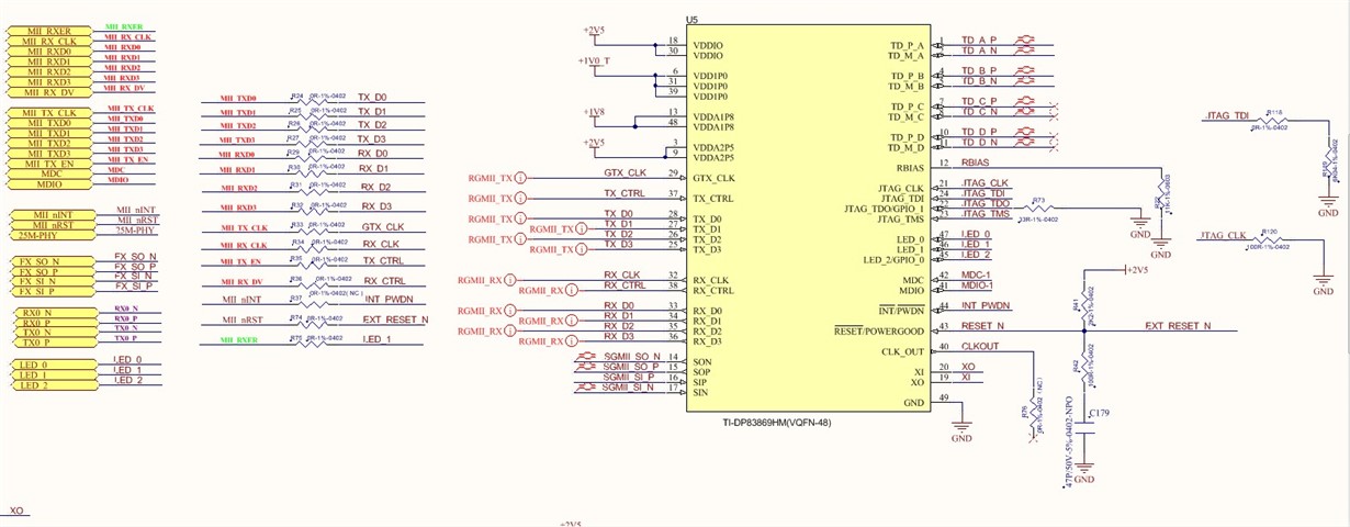

  • Hi Justin,
    These are our schematic :
    We also try to take a MII loopback test. we will get back to you.
    Johnny
  • Hi Johnny,
    Please check register 0x6E and verify that the strap settings you are targeting are reflected as enabled in this register. It appears that you have mirror mode enabled (RX_CTRL pulled high), and are forcing 100M MDI mode on LED_0, LED_1, LED_2. Is LED 2 pulled high through R13 and also connected to the RJ45 pull-down resistor R20? Please confirm that LED_2 is being strapped properly.
    justin
  • Hi  Justin,
    "LED2/nINTSEL"  and “ LED2”  are not the same Net.
    Register 0X006E = 0X20A6
    Register 0x0009 = 6802
    straps for RGMII/SGMII to Copper
    Johnny

    according to SNLA318:
    Configuration for MII-to-Copper is accomplished by setting bit 5 of register CTRL (0x01DF) to 1.
    We tried to do that( Write 0x0060 to Register 0x1DF ), but  Read back the value of Register (0x006E = 0x20A6).
    What's wrong with what we're doing.
    Johnny
  • Hi Johnny,
    Register 0x006E reflects what values are latching into the bootstrap settings during power on and reset. Updated register 0x01DF will not update register 0x006E. To confirm you are in MII mode, register 0x1DF should be updated. You can also perform analog or digital loopback to confirm the MAC data transfer can be conducted over the MAC interface.
    Can you please describe the link partner you are using for this test? Is it an identical DP83869 board or something else?
    Justin

    (2) we already changed the straps for Copper interface to  "Auto-negotiation, 1000/100/10 advertised, Auto MDI-X".
    The current  strap configuration as follows:
    RX_D2, RX_D3 & JTAG_TDO (2:0) = 000  (Default).
    LED [2:0] = 000 -  Auto-negotiation,1000/100/10 advertised,Auto MDI-X.

    We ran multiple tests by changing different patterns between "  LED [2:0] = 000 -  Auto-negotiation,1000/100/10 advertised,Auto MDI-X."  and  " LED [2:0] =111 -  Forced 100M, full duplex, MDI-X mode"
    1.  we've run some tests, and we've gotten consistent answers among  MII loopback、Digital loopback and Analog loopback mode. All the values tested were  0x006E = 0x20AE.
    2.on our tests, MII loopback and Digital loopback were already successful,but  Analog loopback was still  unsuccessful .

    In analog loopback mode, can you confirm that there is proper termination on the MDI pins of the PHY? There should be 100ohm differential termination at the RJ45 connector (This can be 100ohm resistor between TD_P and TD_M or another PHY as a link partner present).
    Justin
  • Hi Justin,
    1.We've run some tests  and  check  details are correct  again.  then we had unintentionally found that cable was loose, so we ran tests  aggin. Finally  analog loopback was successful .Then  we just ran ICMP DEMO  but  we can not ping IP successful . and that Register 0x11= 0x6B02,(the bit 10  is 0 ,link is down ).
    What's this problem?

    Then , we used  forced speed mode for ICMP tests.
     we just connected our board to the switch with  cable.and that using another cable  connect  our computer to the switch. But we can not ping IP successful.
    Register value:
    phy_address:0x0A STRAP_STS (0x6E): 20AE
    phy_address:0x0A BMCR(0x00): 2100
    phy_address:0x0A BMSR(0x01): 7949
    phy_address:0x0A PHYIDR1(0x02): 2000
    phy_address:0x0A PHYIDR2(0x03): A0F1
    phy_address:0x0A ANAR(0x04): 0181
    phy_address:0x0A ALNPAR(0x05): 0000
    phy_address:0x0A ANER(0x06): 0064
    phy_address:0x0A ANNPTR(0x07): 2001
    phy_address:0x0A ANLNPTR(0x08): 0000
    phy_address:0x0A GEN_CFG1(0x09): 1000
    phy_address:0x0A GEN_STATUS1(0x0A): 0000
    phy_address:0x0A REGCR(0x0D): 401F
    phy_address:0x0A ADDAR(0x0E): 20AE
    phy_address:0x0A 1KSCR(0x0F): F000
    phy_address:0x0A PHY_CONTROL(0x10): 5028
    phy_address:0x0A PHY_STATUS(0x11): 6B02
    Johnny
  • Hi Johnny,
    Can you verified that your cable and link partner are expected the signals in MDI mode, and not MDIX. In forced modes this is something to verify.
    Two additional tests to try:
    1. Change the DP83869 from slave mode to master mode in register 0x0009[11]. Set this to '1' for Master mode.
    2. Will your switch and PC support auto-negotiation? Can you test with auto-neg enabled?
    Justin
