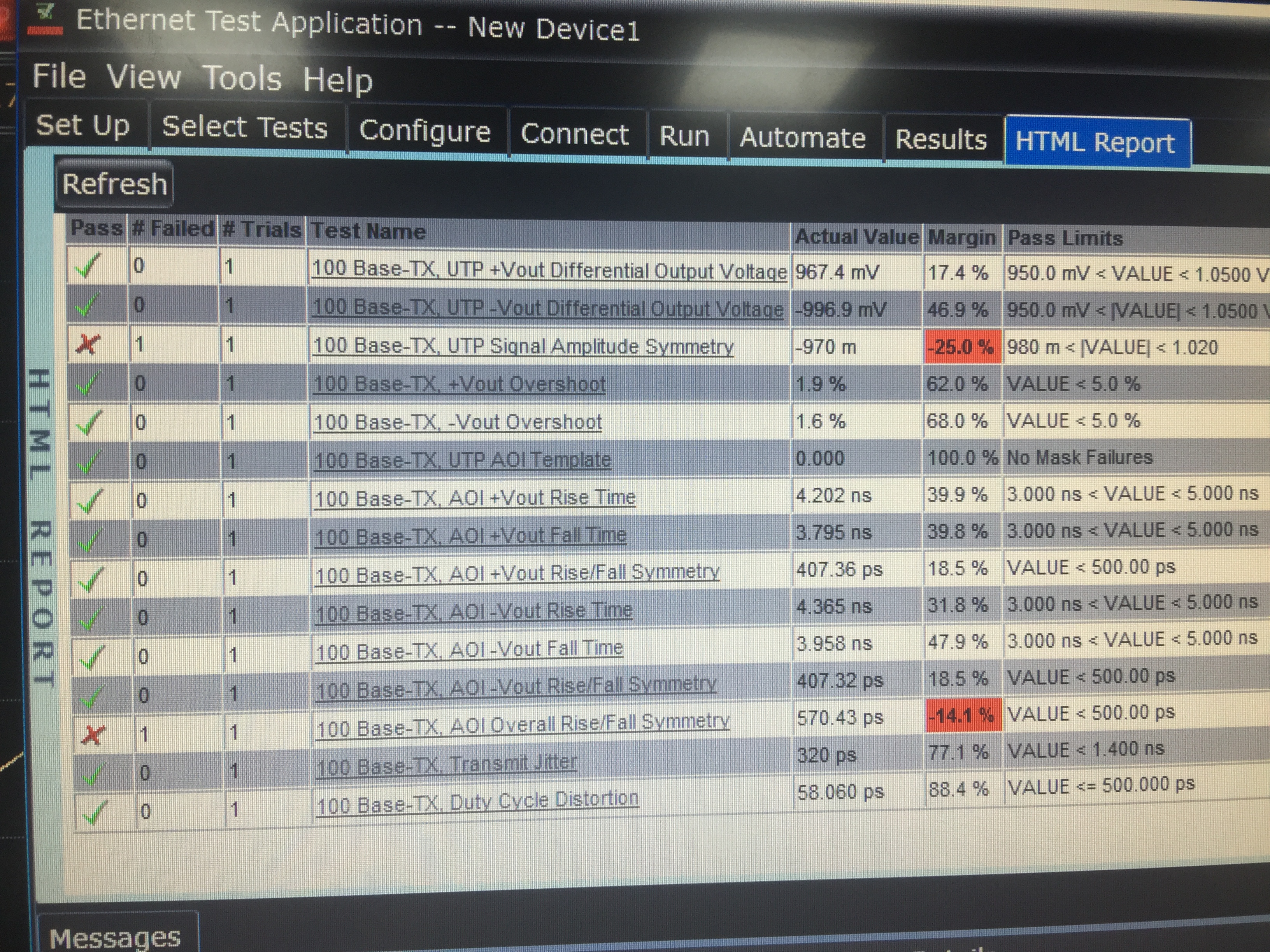

    Thanks you so much! They get right idle waveform with the DEMO scripts.
    However, they failed on Signal Amplitude Symmetry and rise/fall time during 100 Base-Tx compliance test, as below test result shows.
    Do you know if any wrong register value can cause this issue?
    And one more question, is test mode 5 necessary for 100Base-Tx compliance test? If IEEE didn't specified test mode for 100Base-Tx compliance test (Let me know if my information is wrong), why we suggest use Scrambled MLT3 Idles for compliance test? Or it is OK to use normal mode for 100Base-Tx compliance test?
    Thanks and best regards
    Yunjing
  • Hi Yunjing,
    Which channel are you seeing the amplitude symmetry and rise/fall time failures on?
    Yes, test mode 5 is necessary for testing IEEE compliance in 100Base-TX mode. You should not use a normal operation mode because without a link partner, the PHY will send auto-negotiation pulse on the MDI rather than the MLT3 signal.
    Justin
  • Hi Justin,

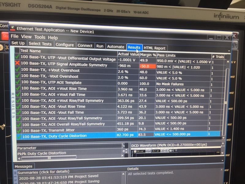

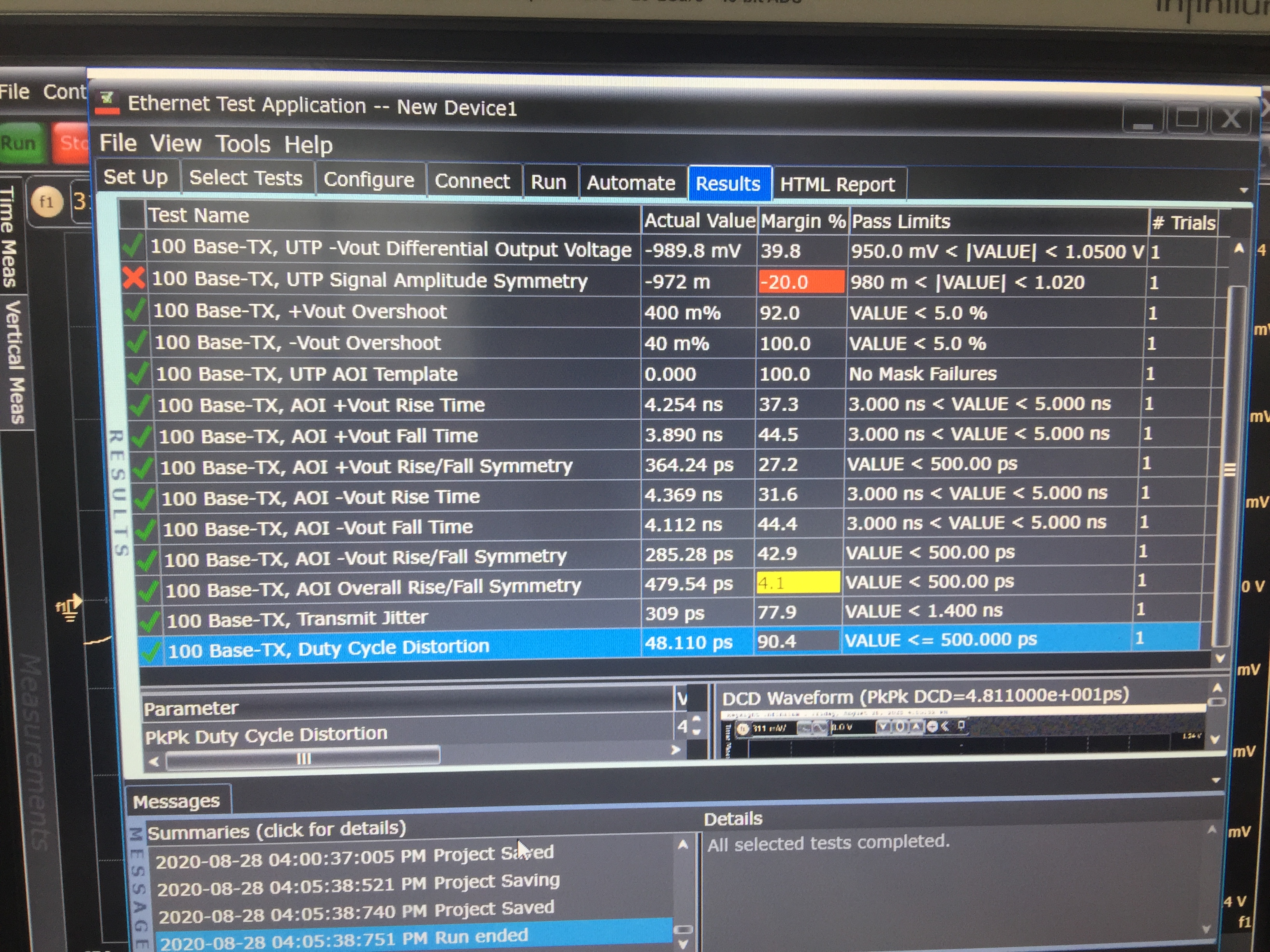

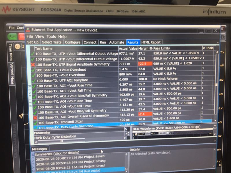

    Channel ABCD all fail on amplitude symmetry and rise/fall time.  See below test results.
    My opinion is that amplitude symmetry failure is caused by potential Impedance mismatch, but I don't have clear direction on rise/fall time failure.
    What do you think? Can you pls share your experience on debug the root reasons of this two issues?

  • Hi Yunjing,
    Can you provide the magnetic component part number and schematic of the DP83869 MDI pins to connector for this application?
    Justin
  • Hi Justin,
    Customer found some error in their driver code, so they need to debug the driver code first, then perform the compliance test.
    I will continue discuss with you through email about this issue when they finish software debug.
