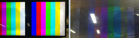

Dear TI Experts:
I am using DS90UB941AS-Q1+DS90UB948-Q1 for MIPI to Dual LVDS display, but cannot found valid LVDS signal output on UB948.
The application as follows, and UB941/UB948 all use the pixel clock:
+-------------+   4 lanes   +-------------+             +-------------+             +-------------+
|        MIPI0|------------>|DSI0     OUT0|------------>|IN0     LVDS0|------------>|   TFT LCD   |
|        I2C17|<----------->|I2C          |  FPD-Link3  |             |  Dual OLDI  |  1920*720   |
|     SOC     |             |    UB941    |   2 lanes   |    UB948    |             |  1280*720   |
|             |             |             |     STP     |             |  No signal  |  1400*900   |
|  1080P MAX  |             |DSI1     OUT1|------------>|IN1     LVDS1|------------>|  1920*1080  |
I just have a demo board which is adapt the current TFT panel(1920*720). So I cannot debugging the board directly with ALP tools but use a shell script as follow:

  • Hello Buridan,
    Let's first isolate the issue by using the pattern generation features of the serializer to make sure that the link between 941AS->948 is working correctly. Can you please follow this guide to generate a pattern from the 941AS to match your display timing? Please take the following steps:
    1. Generate PATGEN from 941AS using internal timing and internal clock (verify functionality)
    2. If #1 worked, then use the same pattern but configure the generator to use internal timing and external clock from the DSI source (verify functionality)
    3. If #2 worked, then enable pattern generation with external timing and external clock
    Please let us know what you find and then we can figure out what to try next based on the results.
    Casey
  • Dear Casey:
    Thanks alot for your help, now I found it does not work at step #3.
    #1. It works when use PATGEN with internal timing and internal clock:
    i2cset -fy $i2cport $seraddr 0x1E 0x01 b
    i2cset -fy $i2cport $seraddr 0x03 0xBA b    # Enable I2C pass through
    i2cset -fy $i2cport $seraddr 0x65 0x04 b    # PATGEN_EXTCLK: internal divided clock
                                                # PATGEN_TSEL: Patgen creates its own video timing
    i2cset -fy $i2cport $seraddr 0x64 0x05 b    # Enable PATGEN/Colorbar/Checkerboard
    I found that the panel just flashing with colorbar each time when power on the demo board while the backlight is always on since the panel worked once. And I measured that there is no valid LVDS signal output when the panel flashing.
    It stoped flashing after execute the script above, but sometimes the pannel color is no longer bright than when it's flashing.
    It may be related to the TFT panel and LVDS timing, now I just could judge whether the LCD is working normally by the flashing phenomenon.
    0 1 2 3 4 5 6 7 8 9 a b c d e f 0123456789abcdef 00: 18 00 00 ba 00 00 5c 00 00 01 30 00 07 30 00 00 ?..?..\..?0.?0.. 10: 00 00 00 8b 00 00 fe 1e 7f 7f 01 00 00 00 01 00 ...?..?????...?. 20: 0b 00 25 00 00 00 00 00 01 20 20 a8 00 00 a5 5a ?.%.....? ?..?Z 30: 00 09 00 05 0c 00 00 00 00 00 00 00 00 00 81 02 .?.??.........?? 40: 04 05 16 00 00 00 00 00 00 00 00 00 00 00 00 8c ???............? 50: 16 00 00 00 02 00 00 02 00 00 c9 03 07 06 44 19 ?...?..?..????D? 60: 22 02 00 00 05 04 00 00 00 00 00 00 00 00 20 00 "?..??........ . 70: 00 00 00 00 00 00 00 00 00 00 00 00 00 00 7f 00 ..............?. 80: 00 00 00 00 00 00 00 00 00 00 00 00 00 00 00 00 ................ 90: 00 00 00 00 00 00 00 00 00 00 00 00 00 00 00 00 ................ a0: 00 00 00 00 00 00 00 00 00 00 00 00 00 00 00 00 ................ b0: 00 00 00 00 00 00 00 00 00 00 00 00 00 00 00 00 ................ c0: 00 00 82 00 38 00 00 64 40 00 00 00 00 02 ff 00 ..?.8..d@....??. d0: 00 00 00 00 00 00 00 00 00 00 00 00 00 00 00 00 ................ e0: 00 00 82 00 28 08 00 00 00 00 00 00 00 02 00 00 ..?.(?.......?.. f0: 5f 55 42 39 34 31 00 00 00 00 00 00 00 00 00 00 _UB941.......... 0 1 2 3 4 5 6 7 8 9 a b c d e f 0123456789abcdef 00: 5c 04 00 f0 fe 1e 00 18 00 00 00 00 00 00 00 00 \?.???.?........ 10: 00 00 00 00 00 00 00 00 00 01 00 00 33 10 00 00 .........?..3?.. 20: 00 00 40 24 08 00 83 84 11 00 00 00 00 00 00 00 ..@$?.???....... 30: 00 00 90 25 01 00 00 c8 00 00 00 07 20 e0 23 00 ..?%?..?...? ?#. 40: 43 03 03 00 60 88 00 00 0f 00 00 08 00 00 63 00 C??.`?..?..?..c. 50: 03 10 00 01 80 00 00 00 00 3f 20 20 00 00 00 00 ??.??....? .... 60: 00 00 00 00 10 00 00 00 00 00 00 00 00 00 00 00 ....?........... 70: 00 00 00 07 07 08 00 00 00 00 00 00 02 00 00 00 ...???......?... 80: 00 00 00 00 00 00 00 00 00 00 00 00 00 00 00 00 ................ 90: 00 00 00 00 00 00 00 00 00 00 00 00 00 00 00 00 ................ a0: 00 00 7d 00 00 00 00 00 00 00 00 00 00 00 00 00 ..}............. b0: 00 00 00 00 00 00 00 00 00 00 00 00 00 00 00 00 ................ c0: 00 00 00 00 00 00 00 00 c0 00 00 00 00 00 00 00 ........?....... d0: 00 00 00 00 00 00 00 00 00 00 00 00 00 00 00 00 ................ e0: 00 00 00 00 00 00 00 00 00 00 00 00 00 00 00 00 ................ f0: 5f 55 42 39 34 38 00 00 00 00 00 00 00 00 00 00 _UB948..........
    #2. It seems worked when use PATGEN with internal timing and external clock:
    i2cset -fy $i2cport $seraddr 0x65 0x0C b    # PATGEN_EXTCLK: external pixel clock
    When I unplug the MIPI(CLK=150MHz) connector, the panel start flashing(No LVDS signal) and until I plugin the connector. So I think the external clock works.
    #3. It seems not work with external timing and external clock:
    i2cset -fy $i2cport $seraddr 0x65 0x08 b    # PATGEN_EXTCLK: external pixel clock
                                                # PATGEN_TSEL: Patgen uses external video timing
    The panel still flashing(No valid LVDS output) after execute the script above, and the dump data as follow:
    0 1 2 3 4 5 6 7 8 9 a b c d e f 0123456789abcdef 00: 18 00 00 ba 00 00 5c 00 00 01 14 00 07 30 00 00 ?..?..\..??.?0.. 10: 00 00 00 8b 00 00 fe 1e 7f 7f 01 00 00 00 01 00 ...?..?????...?. 20: 0b 00 25 00 00 00 00 00 01 20 20 a0 00 00 a5 5a ?.%.....? ?..?Z 30: 00 09 00 05 0c 00 00 00 00 00 00 00 00 00 81 02 .?.??.........?? 40: 04 05 16 00 00 00 00 00 00 00 00 00 00 00 00 8c ???............? 50: 16 00 00 00 02 00 00 02 00 00 c9 03 07 06 44 31 ?...?..?..????D1 60: 22 02 00 00 05 08 00 00 00 00 00 00 00 00 20 00 "?..??........ . 70: 00 00 00 00 00 00 00 00 00 00 00 00 00 00 7f 00 ..............?. 80: 00 00 00 00 00 00 00 00 00 00 00 00 00 00 00 00 ................ 90: 00 00 00 00 00 00 00 00 00 00 00 00 00 00 00 00 ................ a0: 00 00 00 00 00 00 00 00 00 00 00 00 00 00 00 00 ................ b0: 00 00 00 00 00 00 00 00 00 00 00 00 00 00 00 00 ................ c0: 00 00 82 00 38 00 00 64 40 00 00 00 00 02 ff 00 ..?.8..d@....??. d0: 00 00 00 00 00 00 00 00 00 00 00 00 00 00 00 00 ................ e0: 00 00 82 00 28 08 00 00 00 00 00 00 00 02 00 00 ..?.(?.......?.. f0: 5f 55 42 39 34 31 00 00 00 00 00 00 00 00 00 00 _UB941.......... 0 1 2 3 4 5 6 7 8 9 a b c d e f 0123456789abcdef 00: 5c 04 00 f0 fe 1e 00 18 00 00 00 00 00 00 00 00 \?.???.?........ 10: 00 00 00 00 00 00 00 00 00 01 00 00 33 10 00 00 .........?..3?.. 20: 00 00 40 24 08 00 83 84 11 00 00 00 00 00 00 00 ..@$?.???....... 30: 00 00 90 25 01 00 00 c8 00 00 00 02 20 e0 23 00 ..?%?..?...? ?#. 40: 43 03 03 00 60 88 00 00 0f 00 00 08 00 00 63 00 C??.`?..?..?..c. 50: 03 10 00 01 80 00 00 00 00 3f 20 20 00 00 00 00 ??.??....? .... 60: 00 00 00 00 10 00 00 00 00 00 00 00 00 00 00 00 ....?........... 70: 00 00 00 07 07 08 00 00 00 00 00 00 02 00 00 00 ...???......?... 80: 00 00 00 00 00 00 00 00 00 00 00 00 00 00 00 00 ................ 90: 00 00 00 00 00 00 00 00 00 00 00 00 00 00 00 00 ................ a0: 00 00 7d 00 00 00 00 00 00 00 00 00 00 00 00 00 ..}............. b0: 00 00 00 00 00 00 00 00 00 00 00 00 00 00 00 00 ................ c0: 00 00 00 00 00 00 00 00 c0 00 00 00 00 00 00 00 ........?....... d0: 00 00 00 00 00 00 00 00 00 00 00 00 00 00 00 00 ................ e0: 00 00 00 00 00 00 00 00 00 00 00 00 00 00 00 00 ................ f0: 5f 55 42 39 34 38 00 00 00 00 00 00 00 00 00 00 _UB948..........
    So, what's the next step should I do? Is there any configuration error above?

  • Hi Buridan,
    Can you check the register DSI_VC_DTYPE in condition 3 to check and make sure the data type is correct. This register is an indirect register please refer to "DSI Port 0 and Port 1 Indirect Registers" on how to read this register.
    Michael W.
  • Hi Michael,
    With the script function as follow, I dumped the DSI0 and DSI1 registers here after execute the script:

    Dumped DSI1 registers here:
    00: 00 00 00 1d 14 3a 00 00 00 00 00 00 00 00 00 10
    10: 00 00 00 00 00 00 00 00 00 00 00 00 00 00 00 00
    20: 7f 00 ff 7f 00 00 00 00 00 00 00 00 00 00 00 00
    30: 00 20 00 04 00 20 00 00 00 00 02 03 00 00 00 00
    The DSI_VC_DTYPE(0x2A) value is 0x00
  • Hi Buridan,
    Your TSKIP value might be incorrect, what DSI rates are you using on both channels?
    Michael W.
  • Dear Michael:
    The DSI0_CLKP clock is about 150MHz that I messured, and the physical size is 1920x1080 with the command: "adb shell wm size". And the DSI1 is not used.
    I should have posted the wrong data last time, the result after execute the shell  is:
    i2cset -fy $i2cport $seraddr 0x01 0x0f b    # Reset DSI/DIGITLE
    sleep 1
    i2cset -fy $i2cport $desaddr 0x01 0x03 b    # Reset Des DIGITAL
    i2cset -fy $i2cport $seraddr 0x64 0x15 b    # Enable PATGEN/Colorbar/Checkerboard
    i2cset -fy $i2cport $seraddr 0x5B 0x0B b    # FPD3_TX_MODE=Dual, Align on DE
    i2cset -fy $i2cport $seraddr 0x4F 0x8C b    # DSI Continuous Clock Mode,DSI 4 lanes
    ser_dsireg_write 0 0x05 0x1E
    i2cset -fy $i2cport $seraddr 0x01 0x00 b
    00: 18 00 00 ba 00 00 5c 00 00 01 1a 00 27 30 00 00    ?..?..\..??.'0..
    40: 04 05 1e 00 00 00 00 00 00 00 00 00 00 00 00 8c    ???............?
    50: 16 00 00 00 02 00 00 02 00 00 c9 0b 07 06 44 31    ?...?..?..????D1
    60: 22 02 00 00 15 08 00 00 00 00 00 00 00 00 20 00    "?..??........ .
    Dumped DSI0 registers here:
    00: 00 00 00 1d 14 1e 00 00 00 00 00 00 00 00 00 3f
    10: 00 00 00 02 00 00 00 00 00 00 00 00 00 00 00 00
    There is a CNTRL_ERR_HSRQST_3 on DSI0 data lane 3. And the UB948 can not output LVDS signal even I tried DPHY_SKIP_TIMING(150MHz=>0x30) from 0x00 to 0x7E.
    Buridan
  • Hi Buridan,
    Can you try setting the TSKIP_CNT register to 0x0A? and run test 3 again?
    Michael W.
  • Hi Michael,
    There is still no valid LVDS signal output when set TSKIP_CNT=0x0A with the script above but DSI0[0x05]=0x14:
    ser_dsireg_write 0 0x05 0x14
    00: 18 00 00 ba 00 00 5c 00 00 01 23 00 07 30 00 00    ?..?..\..?#.?0..
    40: 04 05 14 00 00 00 00 00 00 00 00 00 00 00 00 8c    ???............?
    00: 00 00 00 1d 14 14 00 00 00 00 00 00 00 00 00 1f
    Buridan
  • Hi Buridan,
    Can you verify that your SOC is outputting LP transitions for every frame of video? what SOC are you using?
    Michael W.
  • Hi Michael,
    The SOC is NXP IMX8QXP(https://www.nxp.com/design/development-boards/i-mx-evaluation-and-development-boards/i-mx-8quadxplus-multisensory-enablement-kit-mek:MCIMX8QXP-CPU).
    I made a mistake on the MIPI0 port abot output data type, I should use MIPI-DSI but the actual output is OpenLDI. And I will try the MIPI-DSI output in the next few days.
    Best Regards,
    Buridan
