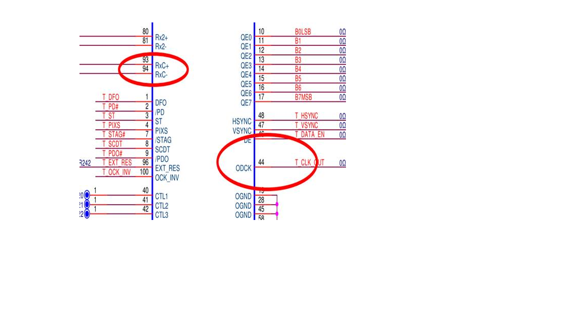

1.Could you help check the TFP401A schematic as below and any need to adjust?
2.The frequency of TFP401A pin 93/94 CLK_IN is equal to pin 44 ODCK OUT?

Hi Gareth,
1. Please remove the AC coupling capacitors on the LVDS outputs of the SN65LVDS93A. Everything else looks okay
2. Yes
