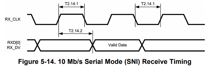

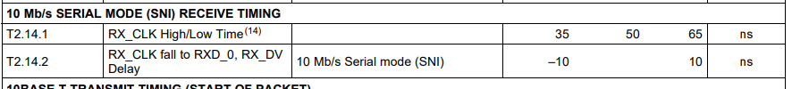

Dear Technical Support Team,
According to T2.14.2 of datasheet, there is "RX_CLK fall to RXD_0, RX_DV Delay" and the delay time from the falling edge of the clock.
However Figure 5-14.10, the delay of  T2.14.2 shows from the rising edge of clock .
Which is correct?
