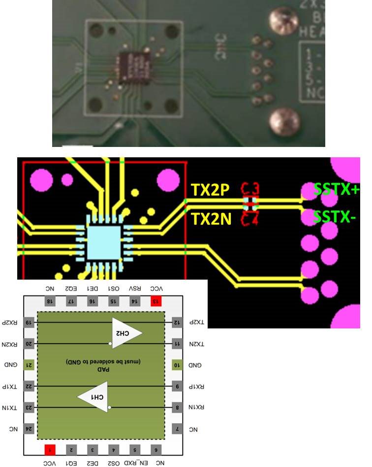

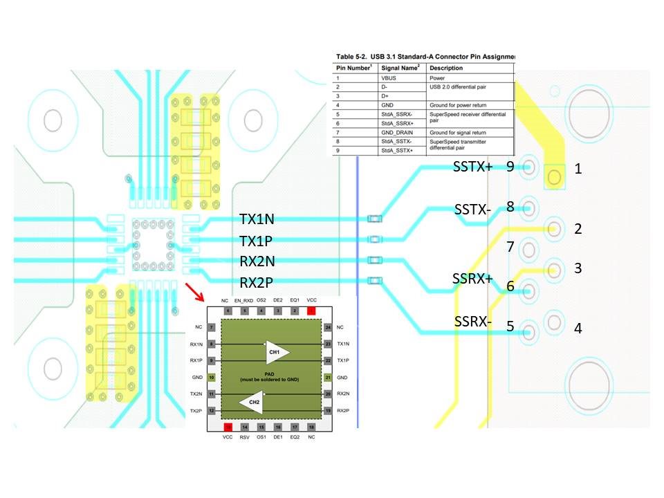

Hi team,
Looking at datasheet 10.2 layout example, it looks IC and USB connector is populated in different surface each other.
Is it corrrect? If so, TUSB522P's SSTXP connects to connectors SSTXN in the layout example. Is this connection no problem?
Saito
