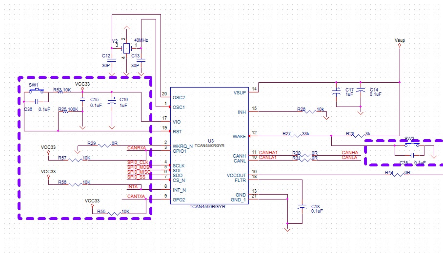

We are using TCAN4550-Q1 for CAN bus for communication.
Please help to check whether the schematic is OK?
We use the schematic to product a prototype for test. The SPI communication is work fine, but when I send CAN message to TCAN4550 there is no message goes out from CANH and CANL.
Then I check the TCAN4550 mode. I set it to normal mode sometimes it will success, sometimes it still in standby mode.
When it success to normal mode, I send some CAN message from other device TCAN4550 get the first one or two message then change the mode to standby mode itself.
I test the same way on TCAN4550EVM It work fine, the mode can still keep in normal mode.
Do you have any idea?

    Two issues I notice immediately with your setup: FLTR pin needs at a minimum 300nF output capacitance, there is only 100nF in your schematic, and VCCOUT needs 10uF of output capacitance, there is none in your setup. One other issue is the CANH and CANL components, are there termination resistors and other filter components elsewhere on the CAN bus? Bus termination is absolutely necessary for CAN communication to propagate correctly.
    It sounds like your device is resetting when you're transmitting CAN frames since it ends up back in standby mode, and not having the right amount of output capacitance on both the FLTR and VCCOUT pins could cause this. The FLTR pin is the filter for the internal regulator that biases the CAN bus. If the CAN bus drivers drive a dominant. without the correct amount of output capacitance, this could place the internal regulator out of regulation and force a device reset through an under voltage condition.

  • Hi Eric,
    After I move the 10uF of output capacitance close to the TCAN4550, the mode is worked fine in normal mode. Transmitting CAN frames is worked fine. But when receiving CAN frames, if frames quickly received the interrupt occurred first one or two then stop occurred. I need to change mode to standby then change back to normal mode. The interrupt can occur again but receive frames quickly it stop again.
