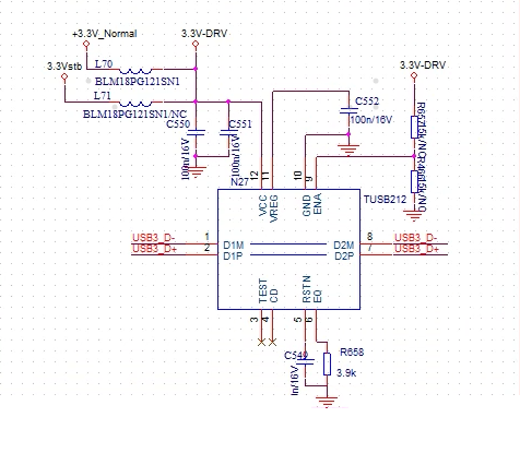

    We tested the industrial version for TUSB212I in customer's aging test(room temp is around 45C, and humidity is around 60%, IC case temp is around 77C), but it still fails when testing the eye diagram. We checked in normal room temp around 25C the TUSB212I works fine with good eye diagram. When it fails in high room temp, we also checked the IC VREG 1.8V voltage is normal.
    As the rough calculation for the thermal resistance and junction temp, it should have enough margin for junction temp under this condition(Tj=77C+62C/W*0.1W=83.2C, <<105C), but we do not know why TUSB212I still fails, can you help to give us any clues? Below is customer's schematic for our device.
    This issue is a little bit urgent for customer's project, kindly help to check it ASAP, thanks a lot!
  • Hi Jacky,
    Could you share the measured eye diagrams and layout for the board the customer is using to test? What is the fail parameter in the test. Please ensure that power is stable during the high temp testing. Does the customer see temp variation from the USB PHY that TUSB212 is redriving? Could you share the customers test setup?

  • Issue was resolved in internal thread.
  • Hi Brian,
    Issue has been closed offline through emails with your team, thanks for the support.
    Update and summary:
    1. Initially the commercial version TUSB212 eye diagram failure rate will be around 0.6% during customer’s aging test(measured IC top case temp about 77°C~80°C), after changing to industrial version TUSB212I, so far no failures reported.
    2. The root cause for TUSB212I Compliance Test Mode eye diagram sometimes failures even under normal room temp, is that we found there is some AC220V voltage leakage for their Oscilloscope, as the earthed pin was not properly connected. After fixing this, by following the steps Malik recommended, no eye diagram failure happened any more.
    3. The root cause for TUSB212I High Speed Mode eye diagram sporadic failures is due to their SoC and USB2.0 Camera enumeration, as from their system log info, we found the camera has been enumerated into full speed device with errors. Customer is still investigating for this software driver problem, but it should be no relation to our device function now.
