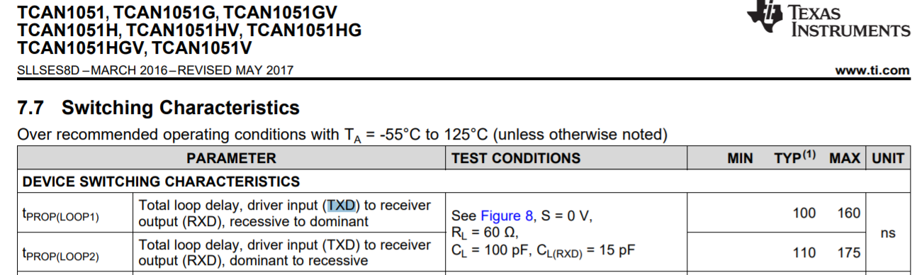

Part Number: TCAN1051H
Dear Team,
Customer would like to replace TJA1051 with TXD to RXD within 200ns
Is the spec. I provide below correct to compare NXP's spec.?
Be
BR
Kevin
