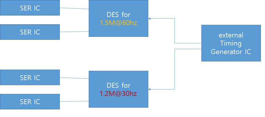

    q5) is there any example system for making different frame sync system ?
    q6) how about below system ?
    If I find out 'external timing generator IC', and I can make different timing sync (1 for 60hz, 2 for 30hz)
    does it work well with TI des 960 and 940 ?

    6. Yes that should work fine. You will need the external generator to send different frame sync signals to the GPIO's of the 940/960 and they can send it to the camera using BC GPIO.
