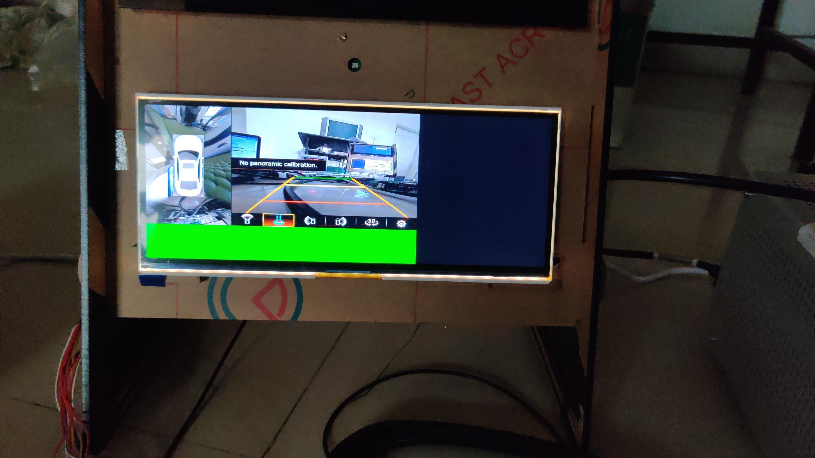

  • We are facing a minor issue. We could see a green patch at the end, as told earlier, we see 935 lines from de-Serializer, we are checking with i.mx6 input as well in parallel( we suspsect a wrong video configuration), but wanted to understand if there is a possibility that de-Serializer does a pass through of the data during VYSNC instead of sending CSI-2 Blanking packets?
  • Hello Rajendra,
    Your analysis is correct. If video lines are sent during the vertical blanking period (HSYNC still toggling while VSYNC is low), then this will be forwarded as additional lines after the FE packet, and the data type will be the same as the active video that you configure in register 0x70. That is most likely what is happening here, and this is a somewhat unusal implementation since BT.656 doesn't typically include HSYNC/VSYNC signal separately.
    I can see two ways around this:
    1. Consult with NXP if the HSYNC signal can be held low during the vertical blanking interval
    2. Adjust the CSI-2 RX SW to ignore video lines which are sent between FE->FS packets
    Casey
