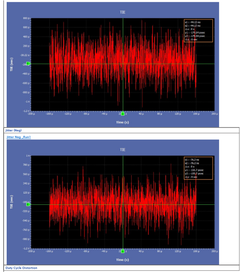

My customer have an issue about Ethernet compliance test fail regarding jitter tests.
Could you please give me your advice for improvement?

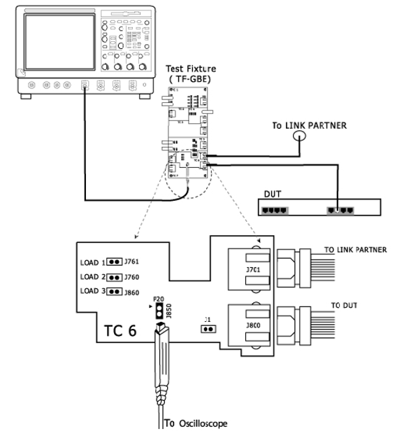

3. Can you please share the script you are using to test the compliance? And, have you confirmed the setup looks similar to figure 1 with the short cable and fixture? I would just like to confirm that the set up is the same so that we can compare the same expected results.
Figure is shown below in this app note.

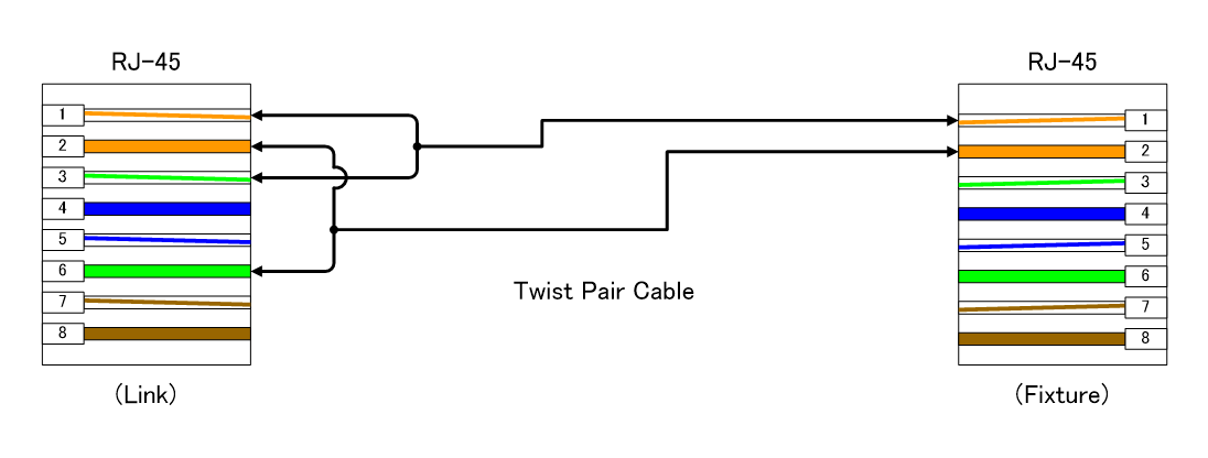

3. The customer has done a different setup.
At the recommendation of Tektronix, the customer created the cable below and tested it with the setup below.
The reason for creating the cable is that it was suggested by Tektronix as a way to improve the situation where the waveform cannot be confirmed.

Would it be possible to try the set up as recommended in our application note and see if that provides different results?

Can you also share the full results with the details of the failure and full numbers recorded?
