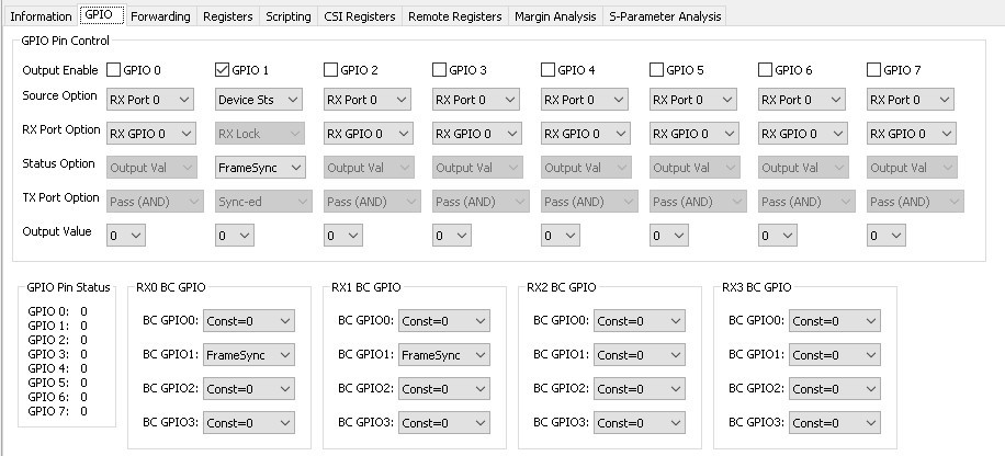

I know that my GPIO is toggling, by looking in the GPIO tab:

  • Hi Hamzeh,
    The GPIO1 toggles in the UB960:

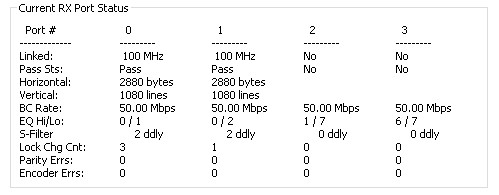

    Link information:
    Matan

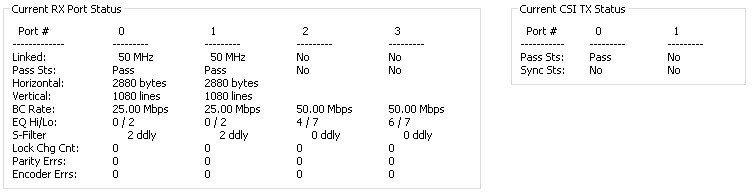

    1) Register 0x58 needs to be 0x5E not 0x5D. 25Mbps BC is not supported.

    Information tab:

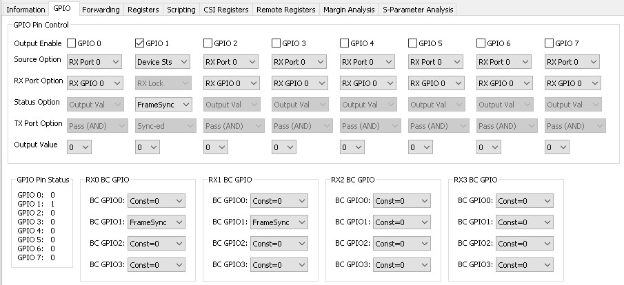

    GPIO tab:

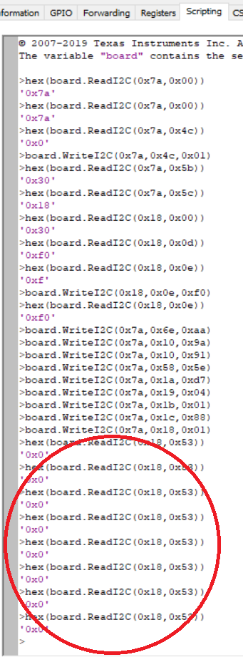

    I read 0x53 register from the remote serializers but get only zeros. I expect to see GPIO1 toggles in this register, right?
    Matan

    I quickly review your issue, it sounds your issue is that the Framesync. can't work, please let me know clearly with below questions:
    1. how do you confirm the framesync. can't work? you read reg. 0x53 on GPIO status in 953, all the returned 0x00? this can't conclude that the framesync. failed as in your setting the framesync. high pulse is very small (600ns @50MHz back chanenl *138 = ~83us, and low pulse is ~750us (duty cycle is ~10%), so in most time you would read GPIO status with "0". you can use scope to measure this gpio signal in 953 side, if it has pulse?
    2. in your "tap imformation", the two cameras had work well, and 953 can decode the received line length  (1440pixles@yuv422) and line counts (1080lines), both had worked well, so pls let me know your concern?

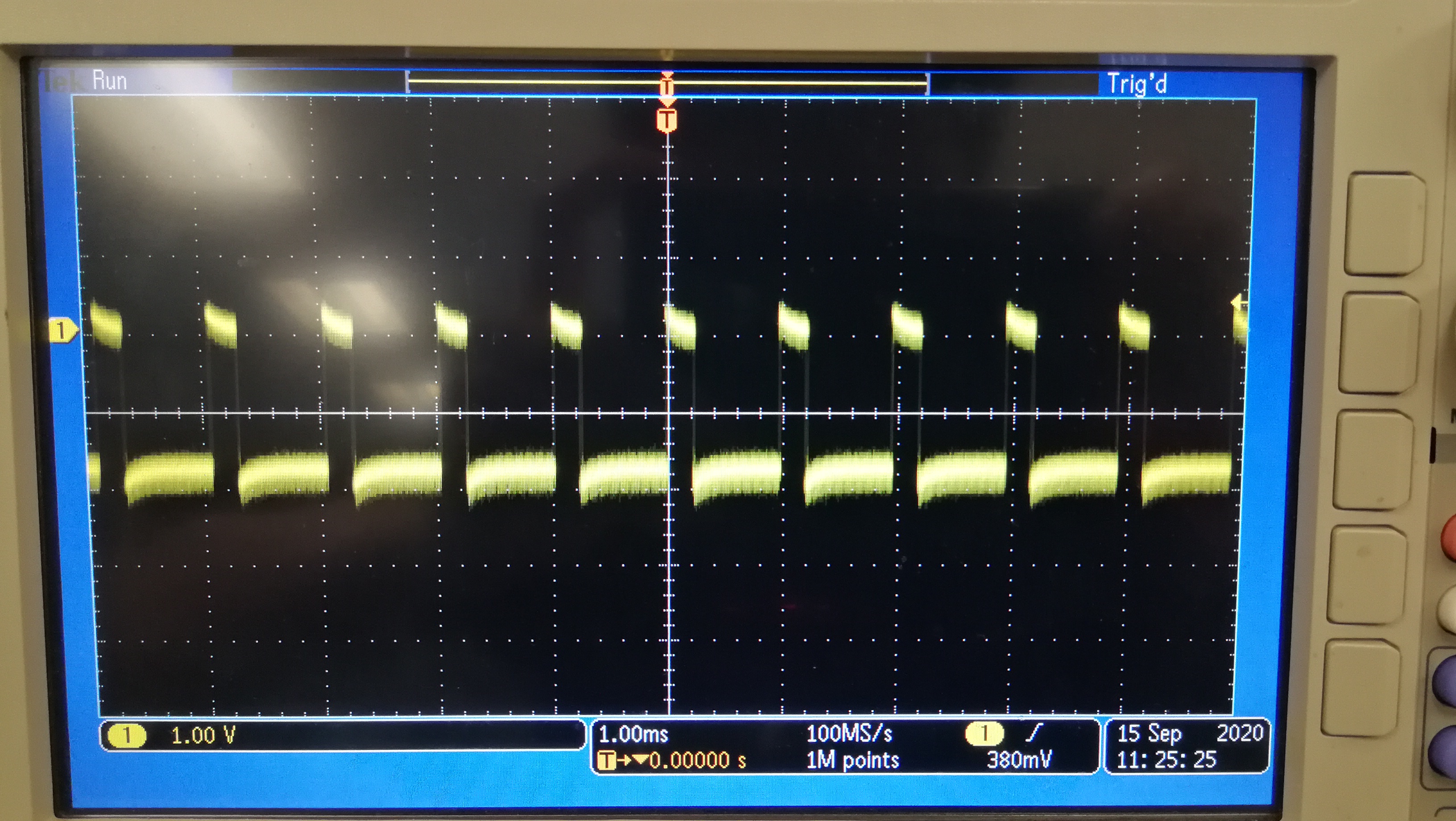

    I had checked it. The script setting provided above can work but as i supposed, you can't read the status of GPO pins when 953's GPIO is set as OUTPUT. please check below RED circle, you can't read it. the other plot is shown to have Framesyc. otuput.
    sorry, we have no other options to read Framesync. output in 953 side if you have no scope to capture it.

  • Hi Steven,
    OK.
    Thanks for the support and effort. I will check it with scope as soon as possible.
