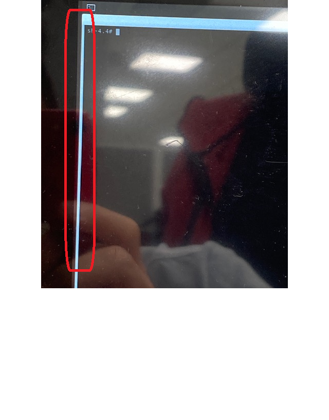

Hi Guys,
I use SN65DSI84 to convert MIPI signals to LVDS signals to enable TIANMA TM070JDHG30.
There are two problems needs your comment.
1. Jitter symptom while moving USB mouse , tap touch panel or typing with USB keyboard.
2. Vertical blank line on left side of the screen.
Below list are related information.
LVDS Panel : TIANMA TM070JDHG30
Resolution : 1280x800
DSI clock : 74.25MHz.
LVDS clock : 74.25MHz
DSI Channel : 1
DSI Lanes : 4
LVDS Channel : 1
LVDS Lanes : 4
DE Mode  is enabled.
HS/VS modes are disabled.
