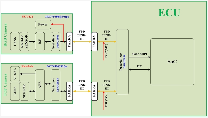

Hi team,
Can DS90UB954 be connected to two cameras with different resolutions as shown below? The two cameras are of different types and there is no frame synchronization. The data format transmitted by the two cameras is also different, one is Rawdata and the other is YUV422.
