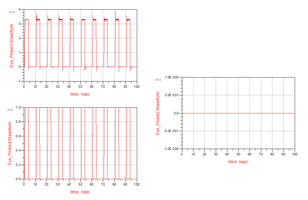

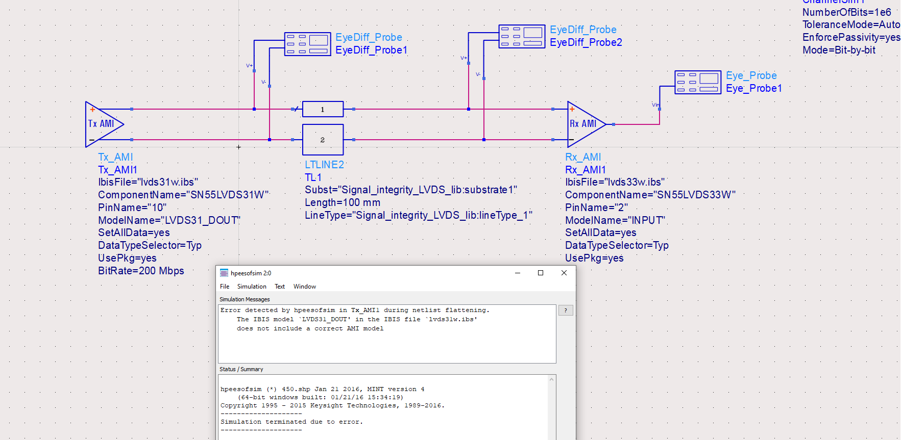

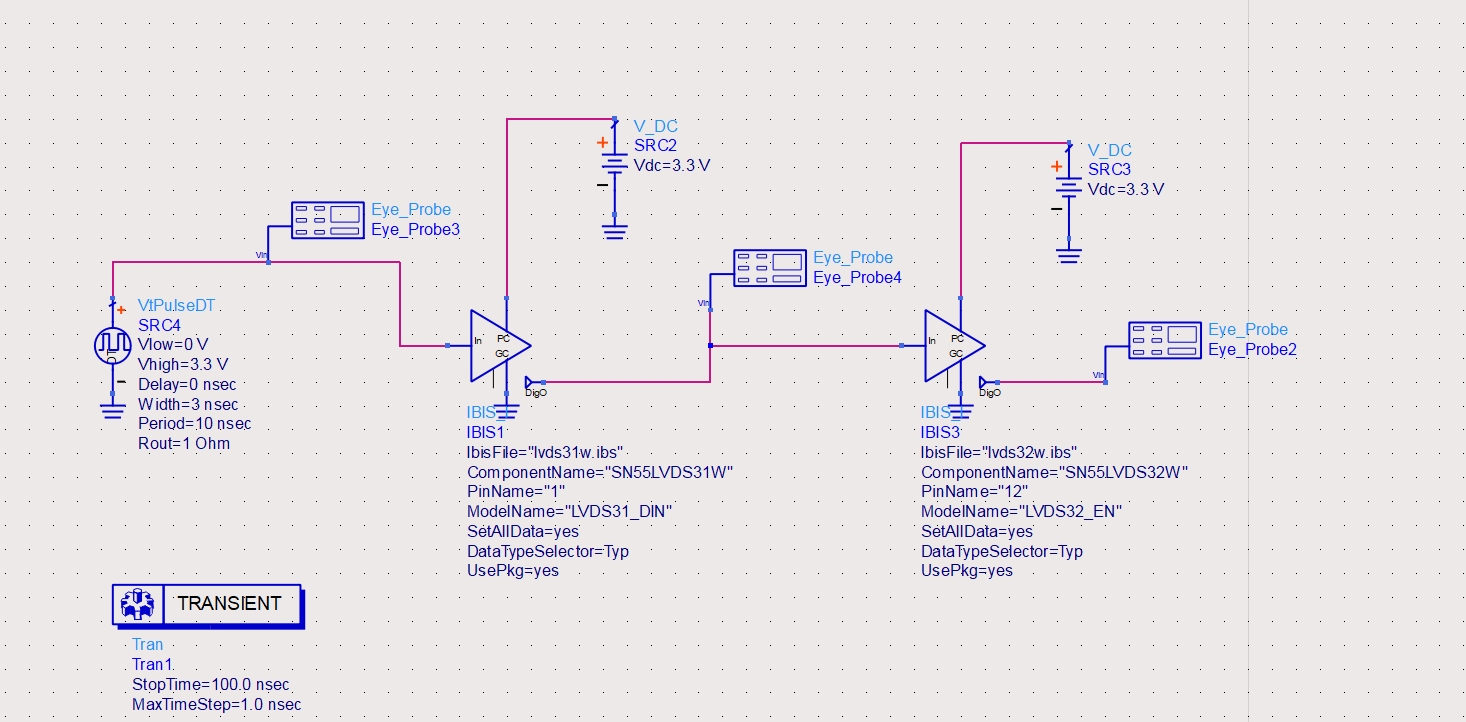

My customer was trying channel simulation with LVDS tx and Rx IBIS model in ADS. It is showing that the IBIS model is wrong. Can you check on this,  attached is the screenshot for reference. Will the model work for Zuken and Hyperlynx only?
