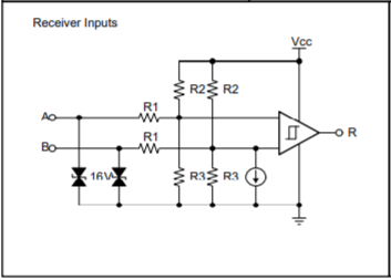

In my design, I plan to use this component but I'm a little bit worried about one scenario.
Indeed, there is one use case where I can lose the supply of the chip while still having a signal on the A & B pins.
A shown in the figure above, there are biasing resistors on the receiver inputs.
I would like to know the typical values of these resistors (R1, R2 and R3) in order to see if it can be problematic in my case.
