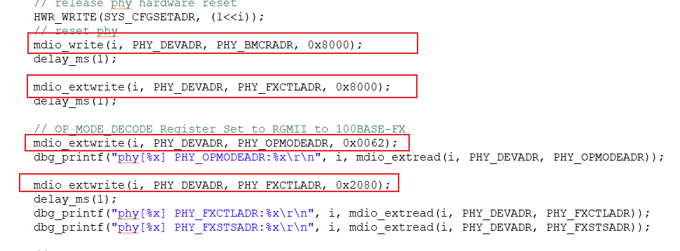

Below is their configuration code.
1. Can you pls help check if there is any issue in their configuration or provide a DEMO code for DP83869HM fiber configuration? MII--100Base-FX mode.
2. Can you pls help clarify the link status judgement logic in DP83869 fiber mode? Is this issue caused by the affection of MAC--MII data transmission?

  • Hi Vikram,
    This is RGMII to 100Base-Tx, full duplex mode configuration. Customer need MII to 100Base-Tx, half duplex mode.
    So their code execute as below.
    • Write 0x0062 to register 0x01DF
    •Write 0x2080 to register 0x0C00
    They didn't  write 0x4000 to register 0x001F to restart the PHY circuit, but this restart is used for 1.11.1(special use case: need switch between copper and fiber).  It shouldn't necessary for normal Fiber use case(no Media switch), right?
    If above code is right for MII-100Base-Tx, half duplex mode, it seems that the link status judgement logic in fiber mode is affected by MAC to PHY data transition. Can you pls help clarify the link status judgement logic in DP83869 fiber mode? Is this issue caused by the affection of MAC--MII data transmission?

  • Hi Vikram,
    Sorry for the typo. They wants MII to 100BFx, fiber mode, not switching modes.
    They configure the registers as below, and they add a link status judgement logic before MAC to PHY data transition, this issue resolved.
    •Link status judgement before MAC to PHY data transition
    That is, after add the link status judgement, when customer plug in fiber cable again after pull out fiber cable, DP83869HM will finally recognize it as Link up.

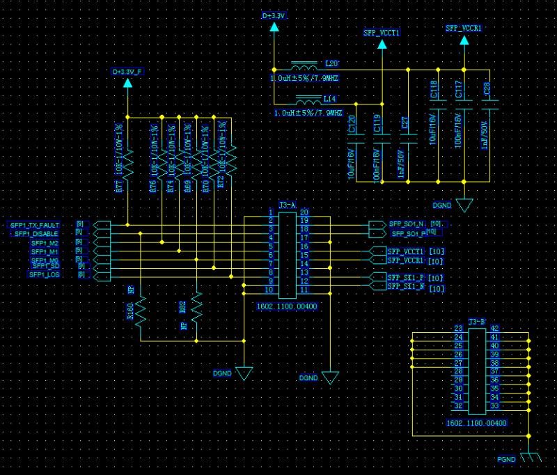

    4. Is there a resistor connected on "tx_disable" pin of SFP to ground? What is the value of that?
    Below is the SFP connection(J3-A), but customer didn't connect the 'SFP_disable' to GND resistor R160. Can you pls. help clarify what issue would cause by this resistor?
    Seems adding <0x001F> = 0x4000 cannot shot the root reason, do you think their software configuration code and hardware schematic will helps find the root reason? If so, I can share those with you by email.
    Thank you & Best regards
    Yunjing

    Further suggestions :
    1. Kindly share the SFP module model number and I will check if we already have any data for this SFP?
    2. Who is the link-partner on other side of the fiber cable? Has customer checked that there is no problem with the link-partner that is causing delayed link?
    3. For some SFPs we have seen that link-up is more robust if we have around 600 ohms of pull down on tx_disable pin of SFP. Can we try this?
    Vikram
