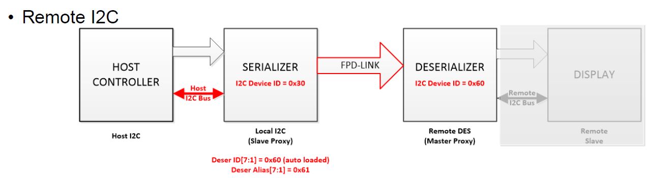

I have a question about doing command from host. Below is my scenario.
As I know, If we would like do command to Serializer. I just read 0x30 device ID and write data directly.
But if we would like to do command to Deserializer. I just read 0x61(Deser Alias ID) and write data, and data could pass through the Serializer and FPD-link to Deserializer, is it right?
