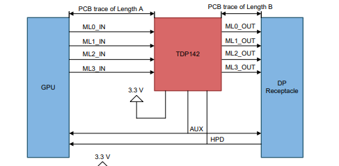

I want to use TDP142 to extend my traces for Display Port, I have two board in total and connected with a flex cable as shown in the figure below :
i notice that the spec mentioned :
My questions are :
1. The trace length A , is inclusive of the length of the flex cable ? (in my case)
2. Can i cascade the TDP142 if i require a longer trace?
    1. No, the example assumes the GPU and the TDP142 are placed on the same board. The trace length A is the PCB trace length between the GPU and the TDP142. But depending on the loss of the flex cable, you can set the TDP142 RX equalizer to compensate for the flex cable loss.
    2. Yes, you can cascade the TDP142 if needed.
    David

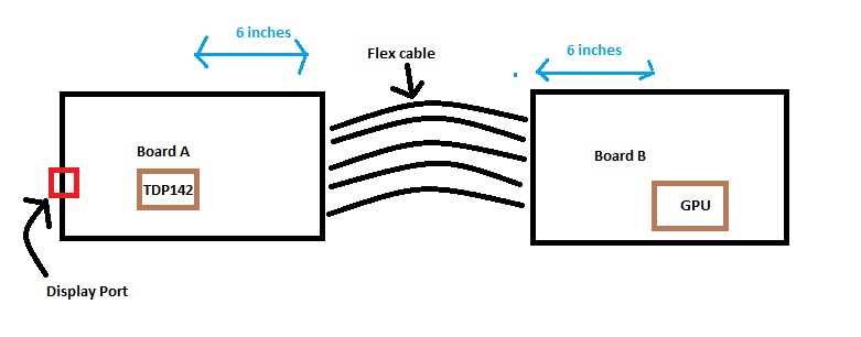

  • Hi David,
    Let say I have 6 mil trace width, which i will have 12 inch length for trace A . i have utilize all the 12 inch on board without including the flex cable, as describe in photo below
    My Questions are:
    1. Is the RX equalizer able to handle this ?
    2. is Cascaded TDP142 a must in this case.
    What is the data rate and do you know how much is the loss of the 12in trace plus the flex cable?
    For example, DP1.4 is 8.1G and Nyquist frequency is 4.05GHz. Let's assume ~0.7dB/in loss for FR4 PCB material at 4.05G, the 12in loss would be ~8dB, this is still within the DP142 maximum EQ of 14.4dB.
    If the loss of the trace, the flex cable, the flex cable connector, etc is more than 14.4dB, this is when you need to consider cascading the DP142.
    David

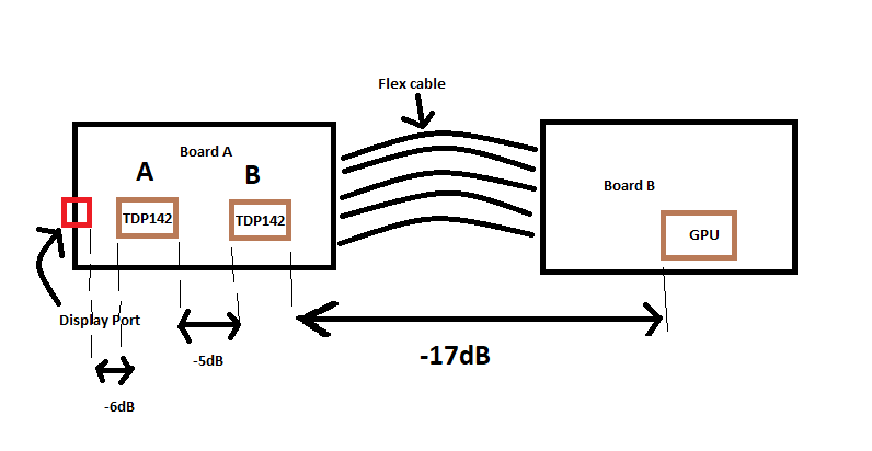

    Let see this scenario:
    Will it work if i set as below :
    TDP142 (B) = 14.4dB
    TDP142 (A) =  8.6dB
  • Desmond
    1. With DP142 supporting up to DP1.4 8.1G, DP142 provides backward compatibility and would work as a DP1.2 redriver as well.
    2. How much is the loss at board B? Is it possible to put a DP142 on board B?
    Do you have a DP142 EVM that you can use to evaluate the DP142 performance with this flex cable?
    David
  • Hi David,
    the loss in Board B is around 15dB, cable loss is 2dB, this is checked using simulation tools. Unfortunately i do not have spaces to put a DP142 on Board B.
    I do not have DP142 EVM on hand.
    -Desmond
  • Desmond
    15dB loss at Nyquist frequency of 4.05GHz is significant amount of loss. If we assume ~0.8dB/in loss for a FR4 material PCB, we are looking at ~18.75 inch trace on board B, does this estimation match with your proposed trace length on Board B?
    The linearity re-driver's linearity region becomes smaller as the EQ goes up. Higher EQ would also result in increasing in circuit noise. This is why I propose having the redriver on Board B to evenly distribute the loss compensation.
    David
