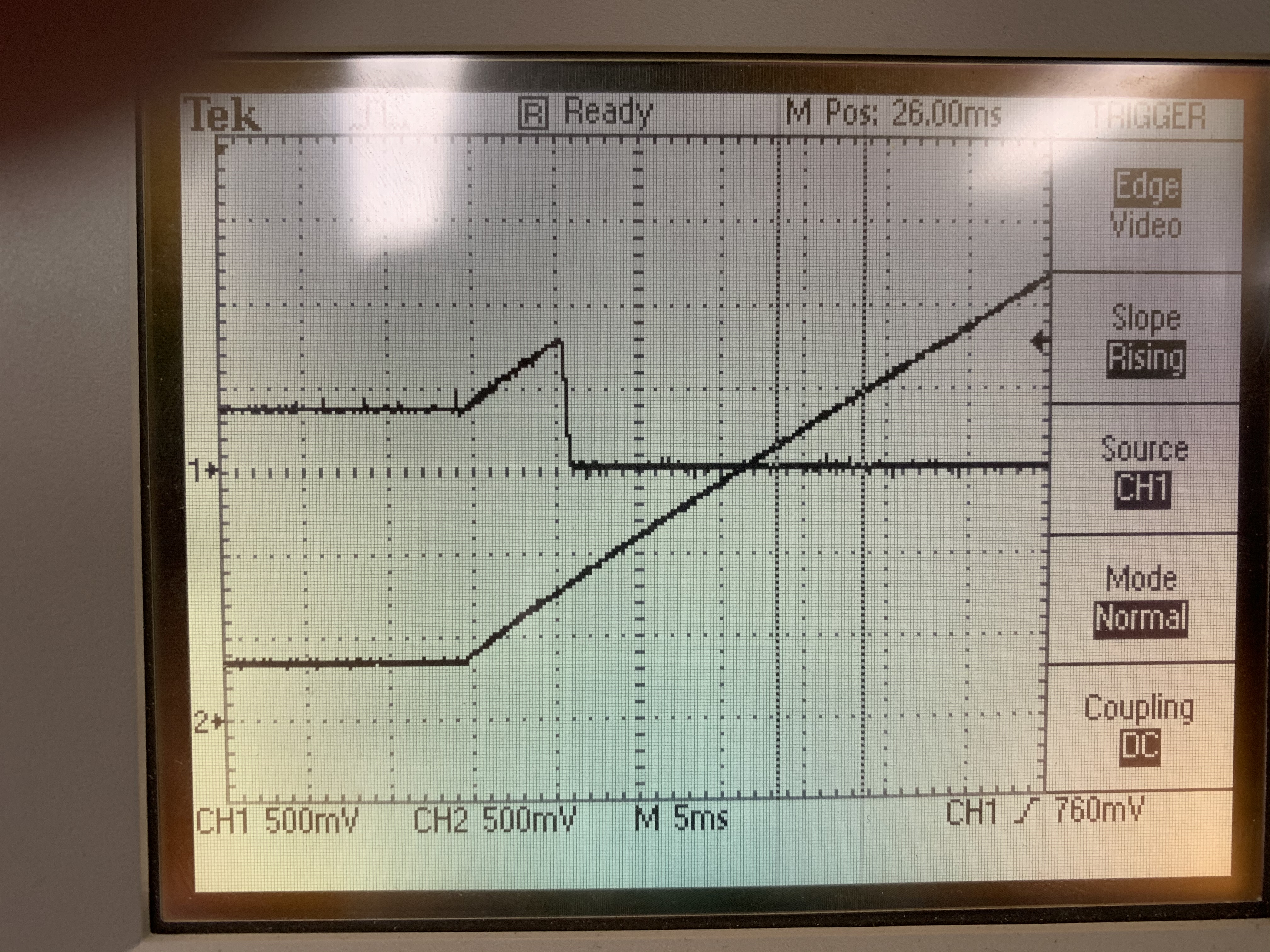

I've read from the datasheet that all I/o ports are configured as inputs at power. However, after a few startup of the device it seems that some of those ports act as a output, specially P03. Is there anything I'm missing about the default configuration ?

    The ports should be initialized as inputs after the device completes its power-on reset.  For this to work properly,the VCC ramp behavior should be within the guidelines given in Section 10 of the datasheet.  Can you please confirm that this is the case for your application?

    When you see one of the ports in an unexpected state, does the corresponding control register have a value that matches?  Or, does it still show the port configured as an input but the behavior is observed to be an output?

  • hi,
    the vcc ramp up from 0 to 3.3V is about 40 msec. For the decoupling, we are using a 0.1uf and a 10 uf. I didn't read the register configuration because it is in default state with no access, SDA and SCK are both pulled up at 3.3V. The behaviour is that once every 10 attempts on powerup, we see the pin drive at 0. (with a 10k pull-up on 3.3V). The specification specifies that all io are configured as inputs on startup.

  • Hi Gaetan,
    Are you able to get a high resolution/zoomed in scope shot of your Vcc ramp when the output pins(like P03) is driving low?

  • Hey Gaetan,
    It looks like the Vcc is sitting around 400mV before it actually powers up. Is there some kind of back biasing occuring on the Vcc line?
    Are you able to do a case where the device powers up from GND? (Maybe place a ~100k pull down resistor on Vcc)
    I have seen problems before where if the device starts at a potential higher than GND, it can sometimes get a bad power up though this is the first time I've seen it happen with this device....
