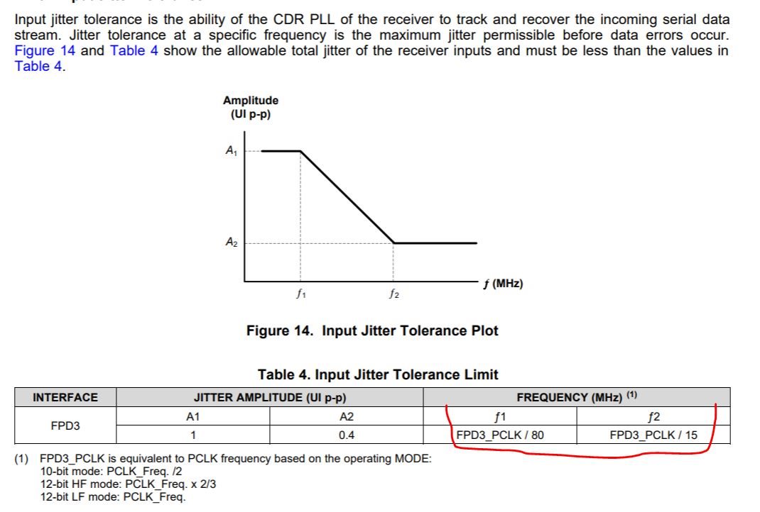

How to understand below jitter tolerance requirement of our DS90UB934?  What's the X axis f1, and f2 represent?
Why define f1= FPD_PCLK/80 and f2 = FPD_PCLK/15?
Also could you share the jitter test detailed procedure to me?(Perhaps send to my Emai?)
