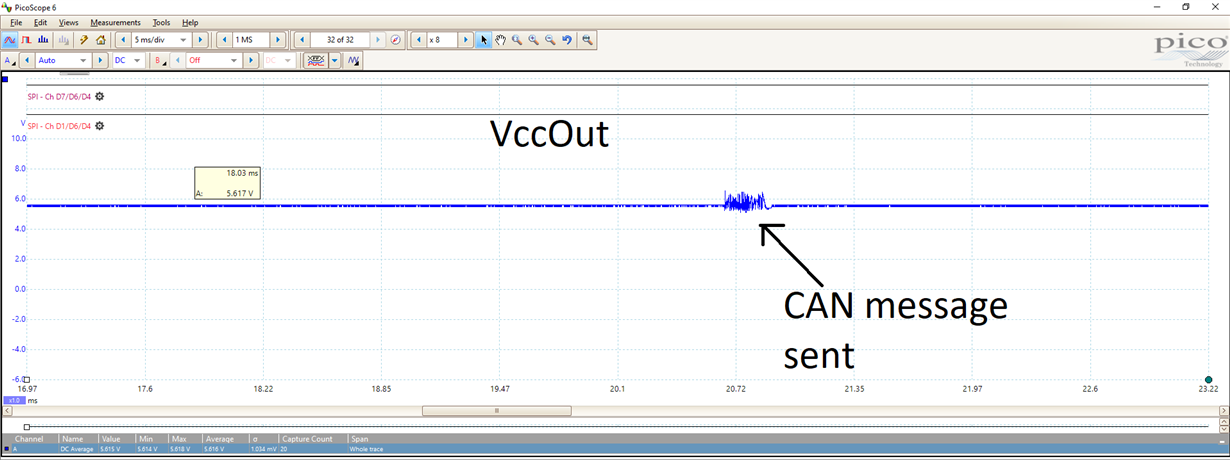

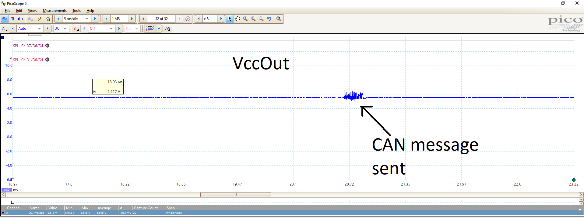

The VCCout  pin gives 5.5V when supplied with 15V supply.

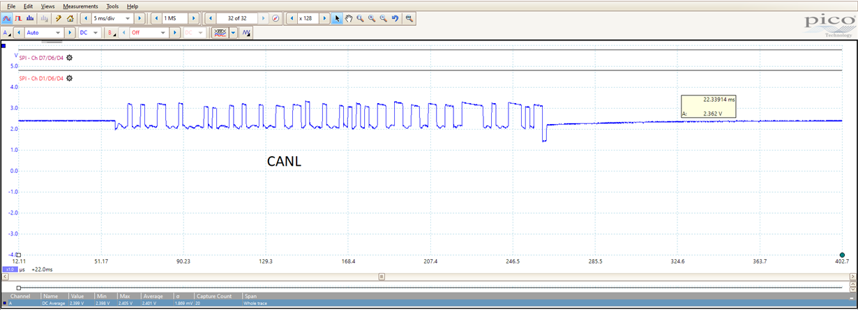

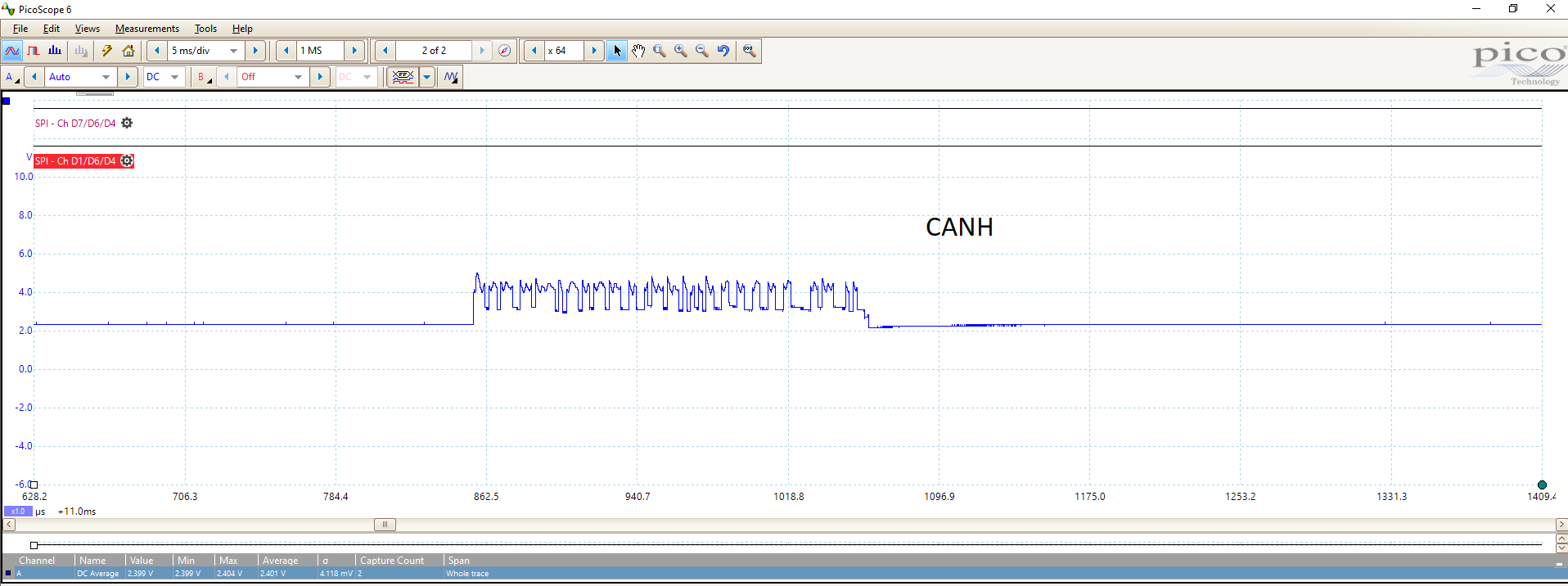

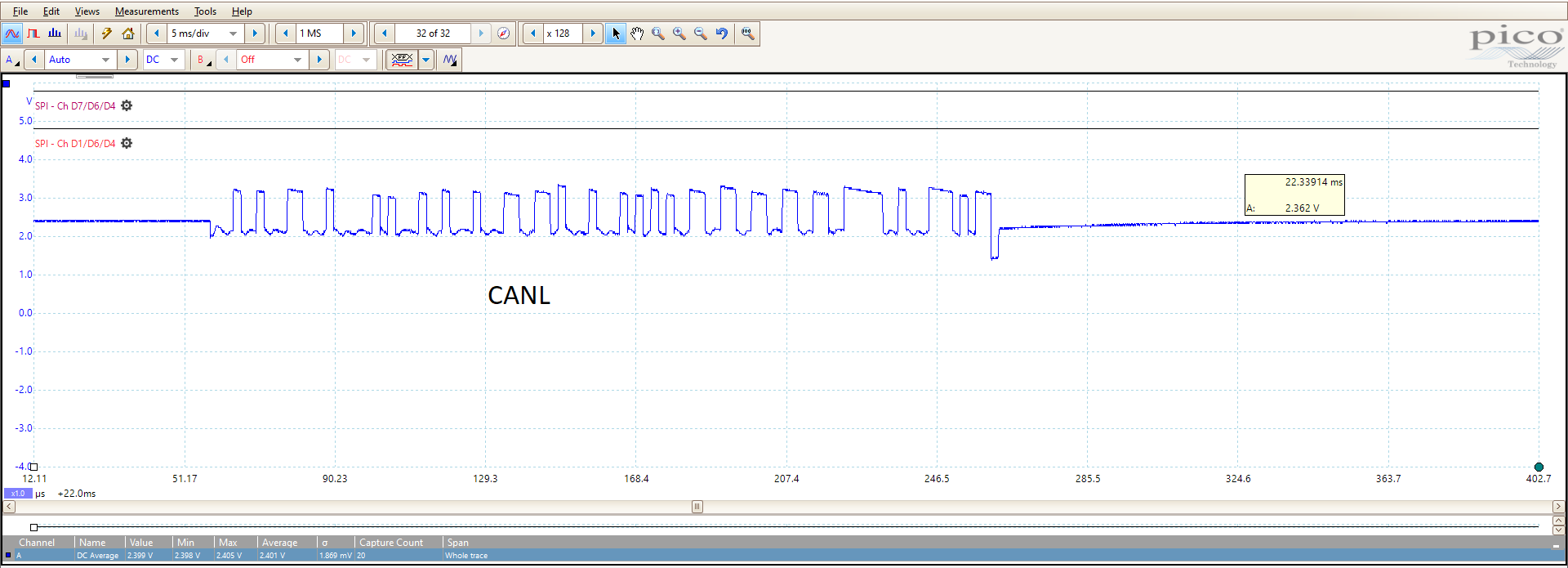

The 0.5V offset in VCCout also appears in CAN bus while message is being sent. The CANH and CANL pins remain near 2.5V and as soon as transmit messages command is sent a 0.5V offset gets introduced and refence voltage becomes 3V while sending CAN message. After transmitting message it returns back to 2.5V. Due to this some CAN messages sent by TCAN4550 are not received by receiver.

  • Below I have attached scope shots of CANL, CANH and VCCout while CAN message is sent by TCAN

    My initial thoughts on the route cause of this behavior is specifically the less than required decoupling capacitance on the VCCOUT pin but generally for all the supply pins (Vsup and Vio) as well.  Please increase those values based on the datasheet values I've recommended and see if it makes any improvement.  I'll try to explain my thoughts.
    The TCAN4550 has an internal LDO that will regulate the Vsup voltage to a 5V voltage.  This 5V voltage is used to power the internal digital core, the CAN FD Controller, and provides the bias voltage for the CAN transceiver and is the source for the 2.5V recessive voltage level on the CAN bus (VCC/2).  The Vio supply powers the level shifting bias circuitry on the digital IO signals and also powers the OSC/CLKIN circuitry, but the digital core primarily operates from the 5V rail.  If the voltage changes too much, it could also create errors inside the digital core and could be the reason messages are not received properly.
    This 5V LDO is capable of providing more current than is required by the TCAN4550 and therefor it can be used to power external circuitry such as a MCU through the VCCOUT pin.   As you have observed, any variation to the LDO's output voltage will directly affect the CAN bus voltage.  Variations in the current load requirements will need to be tracked and accounted for by the LDO and the external capacitance connected to the LDO is a critical component of this circuit.  As I have pointed out, the datasheet states a 10 uF capacitance is required on the VCCOUT pin to maintain output voltage stability.
    When the capacitance is too small, the current load change resulting from a CAN message happens much faster than the LDO feedback loop can track and therefore the voltage level changes as the LDO tries to compensate.  When the capacitance is large enough, the extra current can be sourced through the stored charge in the capacitor and allow the LDO enough time to compensate without causing a change in the voltage level.  The scope capture of the VCCOUT voltage clearly shows that simple activity such as transmitting a CAN message can cause a large voltage deviation which I believe points to the 0.33 uF capacitance added to the VCCOUT pin being too small.
    If you are still having issues after adjusting the cap values, please let me know.  However, I hope that this change will make a noticeable improvement.

  • I checked by increasing capacitance values, now CAN is working properly without errors. However, I am still getting 5.5V at Vccout.

    I'm glad to hear the additional capacitance has stabilized the CAN communication.  However, the 5.5V output voltage is definitely on the high side and greater than the 5.2V maximum specification.  I did not see anything in the schematic that would justify this excess voltage.  Do you have more than one of these boards with the TCAN4550?  If so, do they too measure 5.5V?  I am wondering if this device has been damaged.  If you only have one board, have you tried a different TCAN4550 device on that board?
