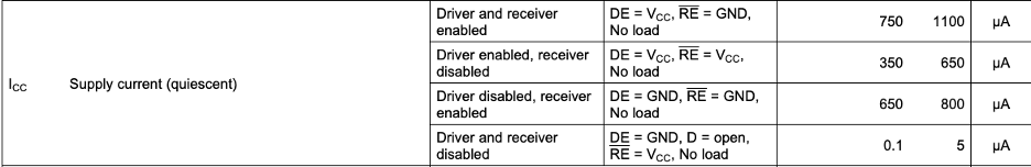

SN65HVD70: the power consumption of RS485
Part Number: SN65HVD70
The terminal device is a slaver with SN65HVD7x,and the device runs at the status of low consumption of power,so that it can not support the IO "output current ,driver and receiver" mentioned in datasheet of SN65HVD7x。
1:as the device is a slaver ,how much power the SN65HVD7x  consume when receiver datas from the terminal device?
