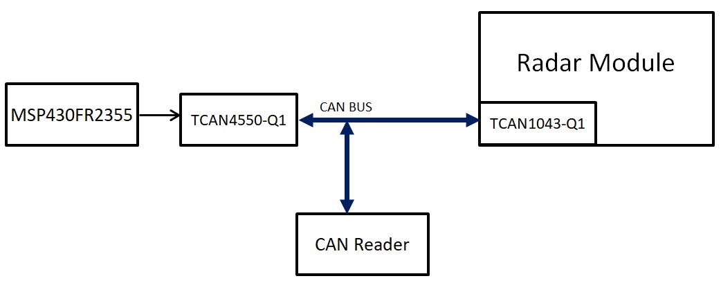

We are testing TCAN4550 in a car system. When the system power up, TCAN4550 ECU operates in the normal mode and keep sending data. At the same time when we hook up another CAN device(Radar module with CAN) on the bus, the TCAN4550 would stop working. And seems enter sleep mode.
Could you help to clarifym with the situation described above, what would happen on TCAN4550? And how we can do in system level to deal with this scenario and make TCAN4550 can resume
If we hook up the TCAN4550 ECU with radar module before system powering up, the interaction of TCAN4550 ECU and Radar module would function normally.

  • Hi Ravi, It's been awhile.
    Attached the testing system block for you reference.
    Hello Jonathan, thank you for supporting.
    Customer test the system with several ways of power up sequence.With below one they faced some problem and would like to clarify the reason and prevent it in MCU coding.
    1. First bring up TCAN4550 ECU(keep sending data), then hook up Radar(powered), and then CAN reader.
    After the operating procedure, RnD found the TCAN4550 would stop sending data and need to recycle power to recover.
    I think it entered more likely as you said the Bus Off state due to unexpected interrupt on BUS. (Should not be the sleep mode after check the device state diagram)

    It sounds like the addition of the introduction of the Radar unit to the bus is causing a disruption that is causing the TCAN4550 to count Transmit Errors.  The 256 threshold is crossed very quickly if the device is configured to automatically retry the transmission of the failed messages.  Once the Radar is powered up, initialized, and ready for normal operation, the TCAN4550 will not detect transmit errors which is why they can communicate after power cycling the TCAN4550.  What they are doing is clearing the Bus_Off state by re-initializing the entire device.  However, this can be done in a more elegant way by simply recognizing the Bus_Off state and resetting the INIT bit.
