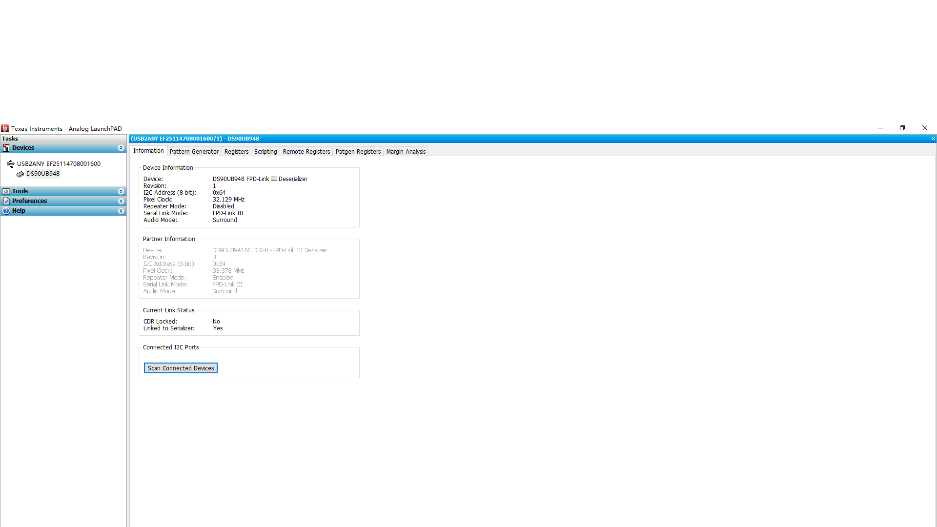

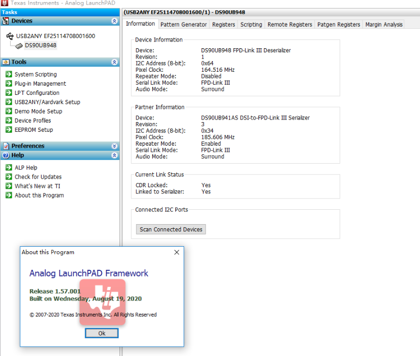

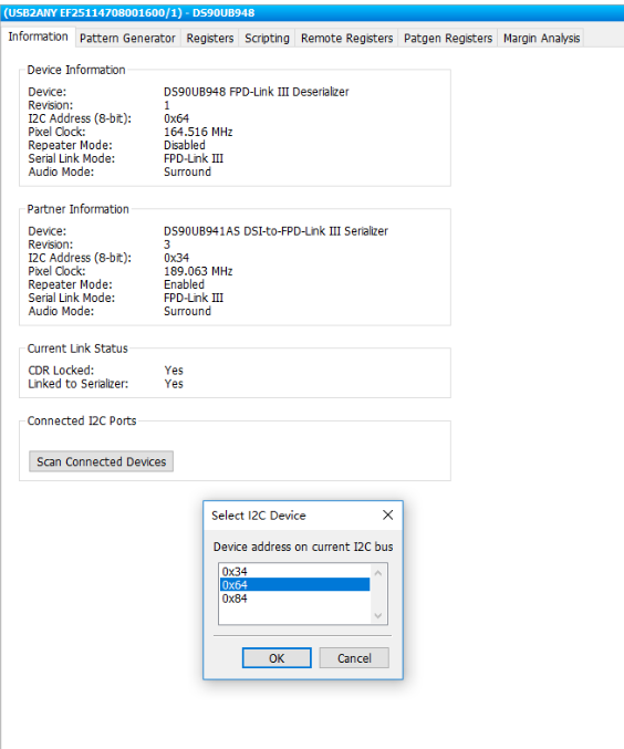

customer is using our MAP TOOLS on analysis 948.
in below picture, should i select the I2C address? for now we selected 0x64

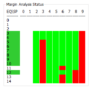

in testing result, what does the SP and EQ in Coordinate System? whether EQ is needed to set through software? How could we adjust?
i attached the testing result as follow and could you help check the result?

  • Brandon,
    Info tab should automatically find the 948 device and update. Scan connected devices allows user to see all the devices on the i2c bus. In case customer design has mulitple 948s on the i2c bus, then he can choose a different 948 device than the one ALP detects.
    SP is Strobe Position which selects when the data is sampled. EQ is the equalizer gain. You can check the following app note and user guide as background. Even though it explains with 954 it applies equally to 948 as well.
    www.ti.com/.../snla301
    www.ti.com/.../snlu243
    What's the cable length you are testing with? All green doesn't look right. Is this with EVM or customer board? If customer board, could you make sure CPU on the board is not initializing 948? We want ALP to control and run this diagnostic test without any external CPU or MCU intereference.

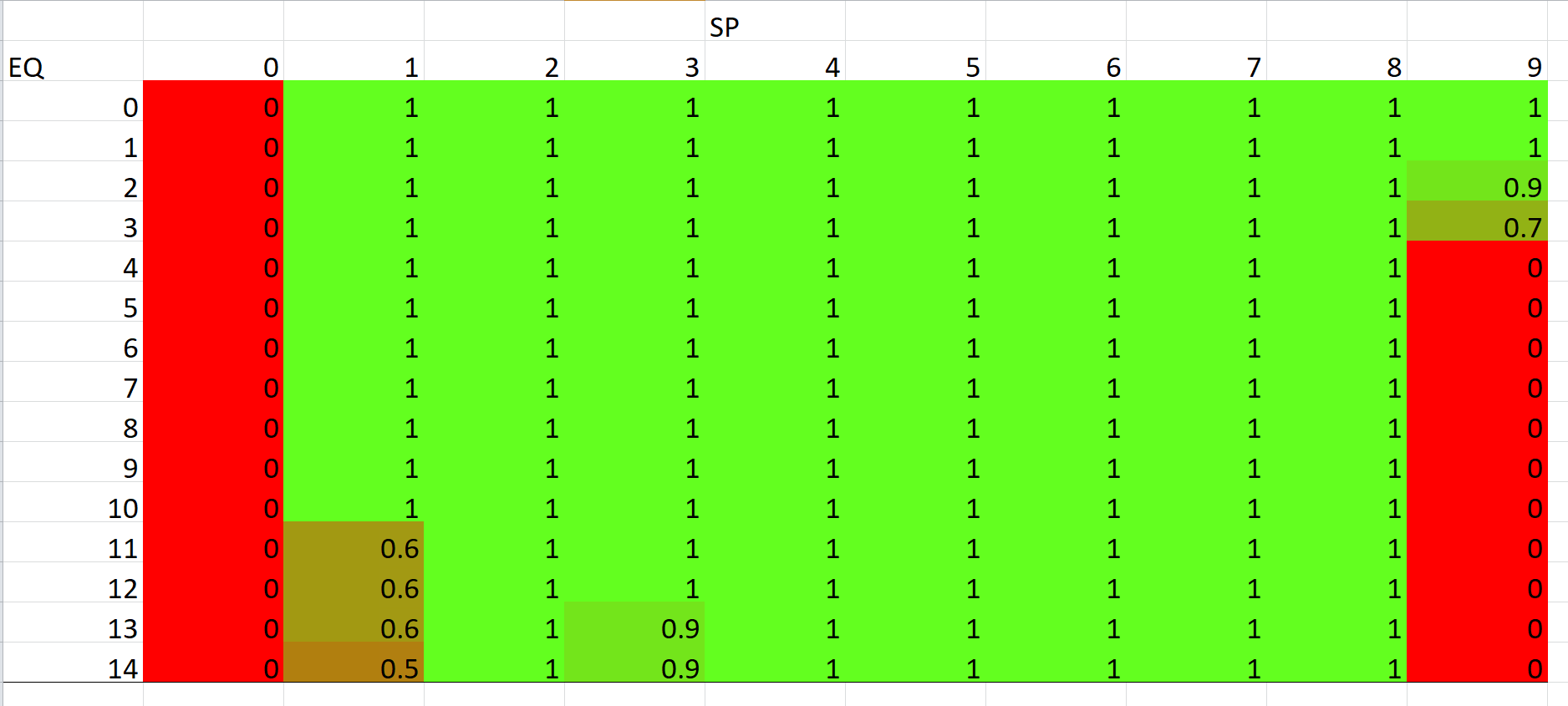

    I was looking at some Map results I had captured with our EVMs (948/949) for 1m. See below
    Above result is obtained by running Margin Analysis Script. The script version is the same as the ALP integrated GUI version except the results are output in a CSV file. You can find the script as part your ALP installation folder (PreDefScripts).

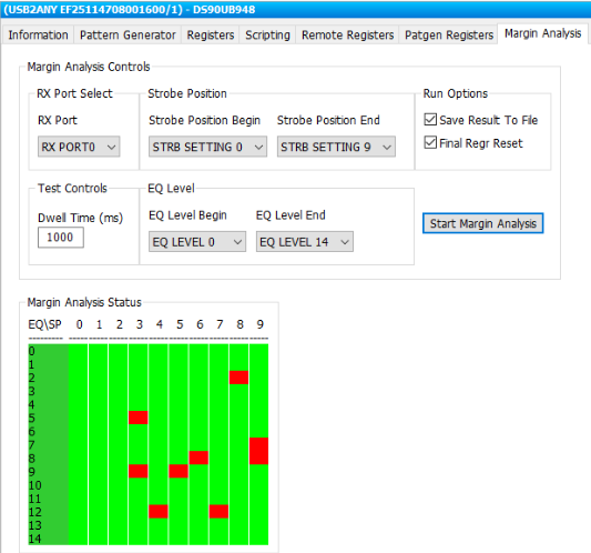

  • One more item: when you run the margin analysis, please make sure strobe setting begin/end selection is 0-9 and EQ level begin/end selection is 0-14.
    Vishy

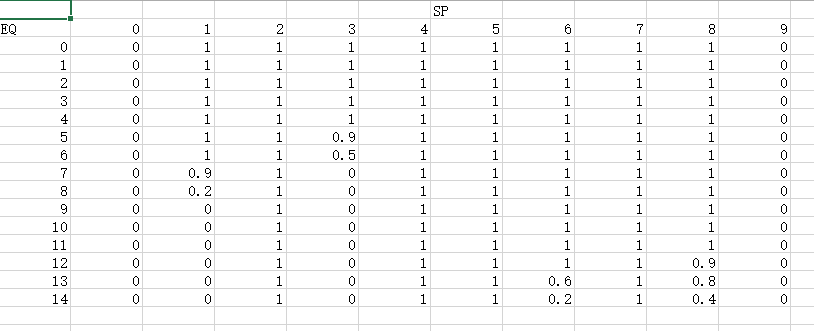

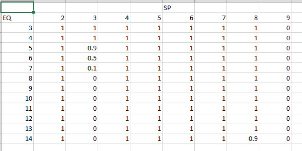

    • The following two graphs are CSV files corresponding to yesterday's test results
    • port0:
    port1:

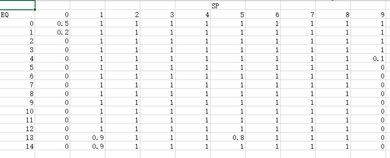

    if strobe setting begin/end selection is 0-9 and EQ level begin/end selection is 0-14,most of the time the results are as follows:
    • Only one test result was as follows:

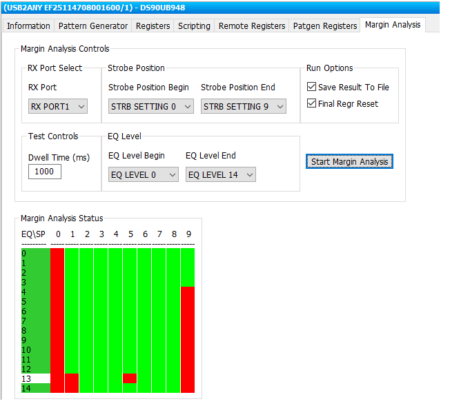

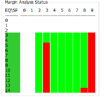

  • Hi,vishy
    By setting bit2bit1bit0 to 011 for register 0x5B, I can now measure Port1. The I2C of the 941 is also disconnected. The following is the test result. Please help to check whether it meets the requirements.
    port0:
    port1:
  • Hello Michaux,
    Thank you for the update. The port1 result looks very good and almost perfect. Port 0 result is ok but not ideal as channel 1 and showing more insertion loss. Is the port 0 cable same like Port 1? May be you could try with a different cable (or the Port 1 cable) and also compare/review your setup  & layout between port 0 and port 1.
