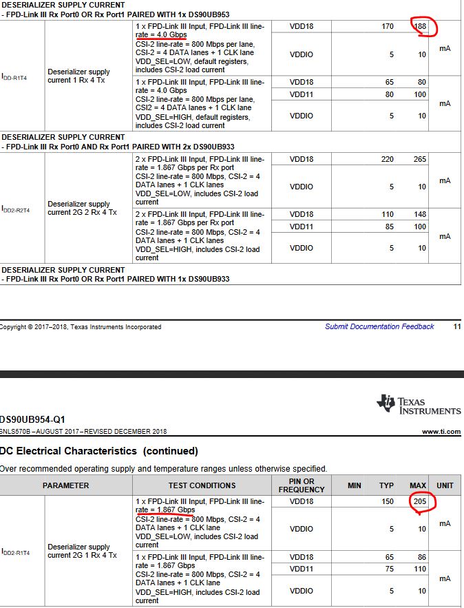

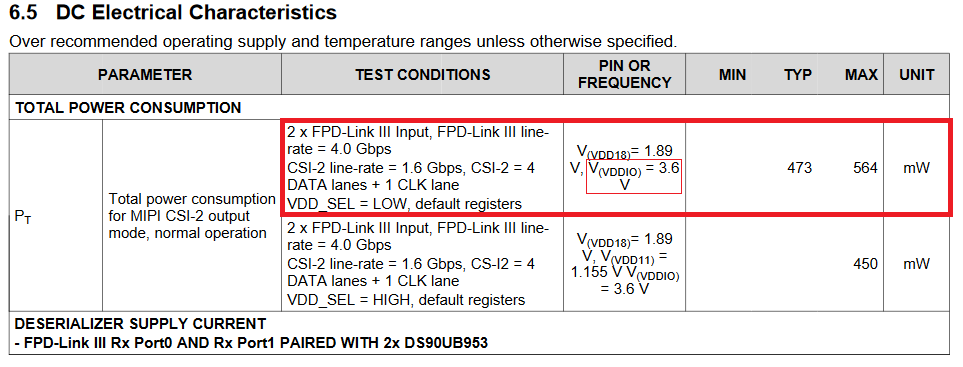

1. Total Power consumption
Total power consumption showed in Datasheet. But the V(VDD18)=1.89V; V(VDDIO)=3.6V; PT= 564mW. If V(VDDIO)=1.8V. Do we have power consumption data?
2.Power consumption on different speed
It described in 6.5 of datasheet. When FPD-Link Line-rate= 4.0Gbps, the max current on VDD18 is 188mA; When FPD-Link-rate= 1.867Gbps, the max current on VDD18 is 205mA. High speed for low power consumption. Could you help us to understand it?
When FPD-Link line-rate= 1Gbps, VDD18=VDDIO= 1.8V, What's the max current on VDD18 and VDDIO?
3.If RIN1+、RIN1-、CLK1P、CLK1N、XOUT is unused, how to deal with it?
Best Regards
Songzhen Guo
  • Hi, regarding the issues listed above, pls check:
    1. No, we have no such data, meanwhile,it is not necessarily as you must take care of the worst case to evaluate your power consumption if considering the power variation.
    2. no we have no such data, we just gave some typical cases for character
    3. you can follow up d/s guideline.
    regards,
    Steven
