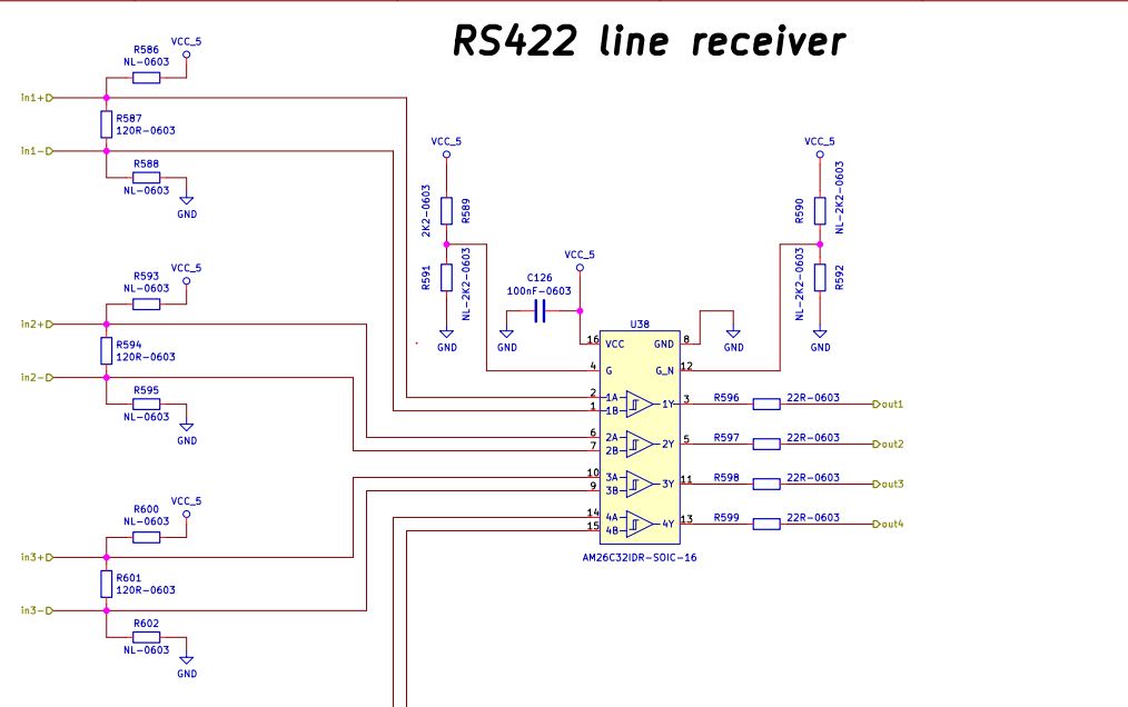

AM26C32: Can we left active low select(G_N) as unconnected
Part Number: AM26C32
As per datasheet i have gone through truth table which is given for G and G_N selects for this IC. This table is given at Page no.9 of datasheet.
In my circuit i want IC to be enabled continuously so,i have Pulled-up G to +5V using 2.2 Kohm resistor and made G_N as unconnected(Support of Pull-up/down is available through DNP Resistors).
(1)Will this circuit works for above configuration?
(2)Will this circuit work if i pull-up G to +5V and Pull-down G_N to GND?
