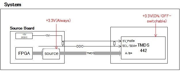

Hello team,
The customer would like to know the electric stress in the following case.
In the power saving mode, the Reciever Board (TMDS442) is powered off, but the Source board remain power on. So the VIDEO signal and +5V/DDC are output to the reciever board (TMDS442) .
Is there any problem in terms of electrical stress?

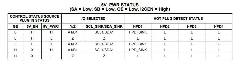

When the power off, is the TMDS442source side (+5V_PWR, SCL/SDA, A/B*) Hi-Z?
Your help would be so appreciated.
