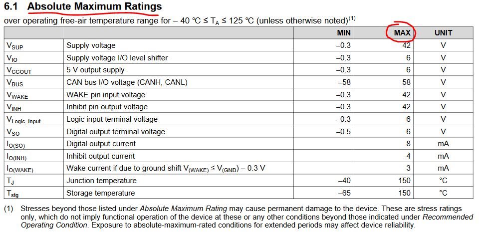

1. For the Absolute Maximum Ratings, such as max supply voltage=  42V. Is there any time limited for this data?

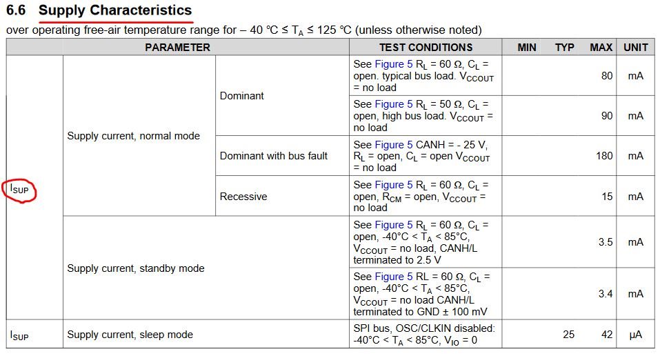

2. In page 5 of datasheet(Chapter 6.6). There is a current data. What's the supply voltage?

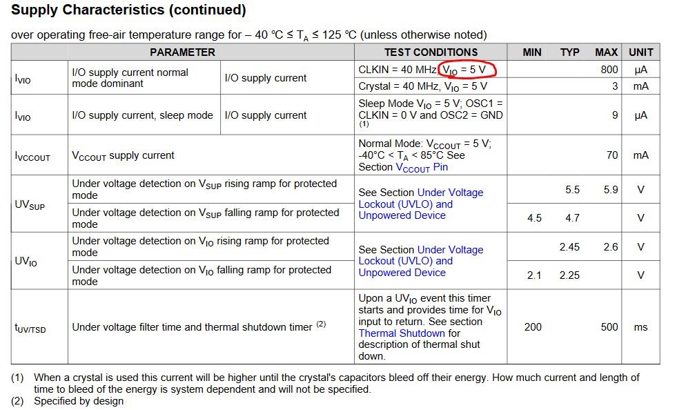

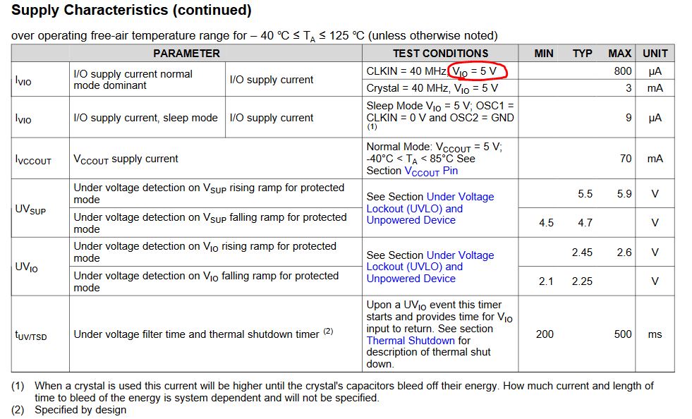

3. For the page 6 of datasheet(Chapter 6.6), when the Vio= 5V, it shows the Ivio data. Could we provide this data under Vio =3.3V?
    No, we do not have any time limit specifications associated with the Absolute Maximum Ratings.  However, these ratings such as the 42V max supply voltage are intended to be for tolerance of transient voltages and not a steady state operating voltage.
    The Supply Characteristics Table specifies the maximum Isup current across a range of Supply Voltages.  Data was collected and aggregated for the following voltages to make these specifications 5.5V, 12V, 24V, and 30V.
    Many factors go into the determination of the datasheet limits for a specific set of test conditions.  I don't think we can provide a specific datasheet limit or the 3.3V case at this time, but I could look into data that was collected for this parameter and give some more specific values for informational purposes only.  I think that is what you are asking and if so let me know.  But if an official datasheet update for 3.3V data is needed, this is a much more significant request that would require some consideration from the product line before agreeing to provide that update.
