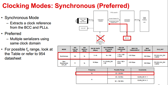

953/954 could support extracts a ref clock from BCC and PLL,could 933/964 could also support this?
Part Number: DS90UB933-Q1
Hi Team,
Hello Amelie,
933 does not have a synchronous mode. This only applies to our CSI-2 serializer products like 953
