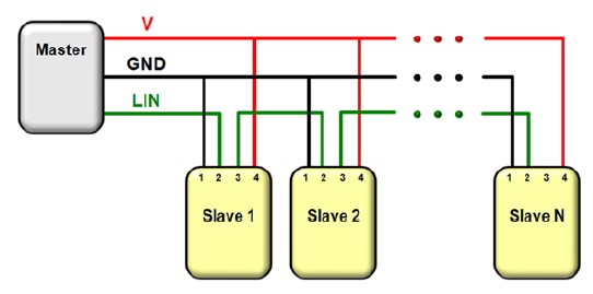

    The 14 series connections are connected as follows.

  • Cho,
    The transceivers will function properly in this configuration up to 16 nodes, correct. Is this daisy chain approach also using redundant TXD and RXD connections on the controller side of the transceivers?

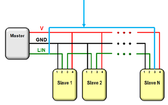

    The customer's answer is as follows.
    In the last Slave Node, the communication line ends and does not connect directly to the Master (Controller).
    Please check if the question I understand is correct.
    Should I check if the yellow TX/RX shown below is connected to Slave1 and 2~N as well?

  • Cho,
    I just want to make sure I understand the TXD and RXD connections in the LIN cluster. Since the signals are being daisy chained between two LIN bus pins on the TLIN1022, they will transmit and return data to two separate TXD and RXD pins (TXD1 - LIN1 - RXD1, TXD2 - LIN2 - RXD2). I just want to understand how the customer is connecting the TXD and RXD pins to their respective controllers.
