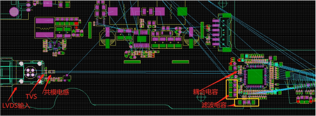

I have question about DS90UB926-Q1 position between LVDS input and LCD display. customer board is narrow and long,they want to konw which side the 926 should be closer to? I think it should be close to LCD display, right?
one more question.below is customer layout draft, customer want place capactiors on the same layer of the chip, does below layout is recommened?

    The FPD-Link signal will be at a higher frequency than the RGB data, so generally the 926 is best to be closer to the FPD-Link connector. This answer can change though depending on how long the RGB data is traveling to the display and how long the FPD-Link cable is.
